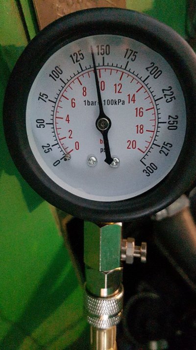

Hi, i did some pressure test on my restored 845cc engine,all readings were exactly 140 psi, where i can find original values what those should be?

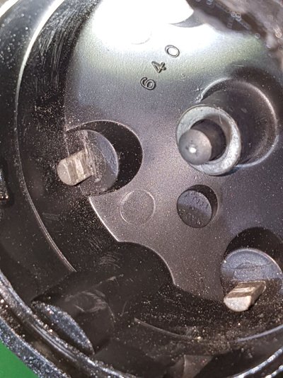

Another thing, sparkplugs look like this and to me at least cylinder 1(which is towards driwer) burns best? Any assumptions what could be wrong on 1-2-3 , inlet valve clearances too tight, distributor /distr cap most close to cyl 1, diff spark plugs quality, ignition wires(of course lengths are diff. I am questionning this due petrol owerconsumption? difficult to start and jerky drive.It takes revs fast and runs finally good and has electric ignition....and also tremendous Zenith 28 IF carb.
Some advices are highly appreciated.
Yesterday i did check and clean sparkplugs and check clearances. All Ok.Then i did check the distributor cover(it's not the original one) and looks like there is some kind of wearing(or electric cavitation on each of the nips inside the cover.Nips are here of aluminium and the original was of copper.What do you think- does the rotor arm and distr cover work together fine and/or the distributor sfat has worn out that it is woffling around? Motor started fine w-out choke after cleaning of the sparkplugs but it was not very smooth more like it was running with three cylinders at forst and could not resist more gas, like it was suffocating but when use choke very carefully started to run better(all the tiome w-out air filter and teh housing.
