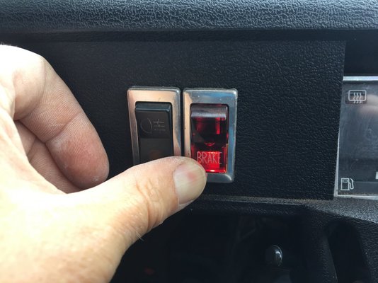

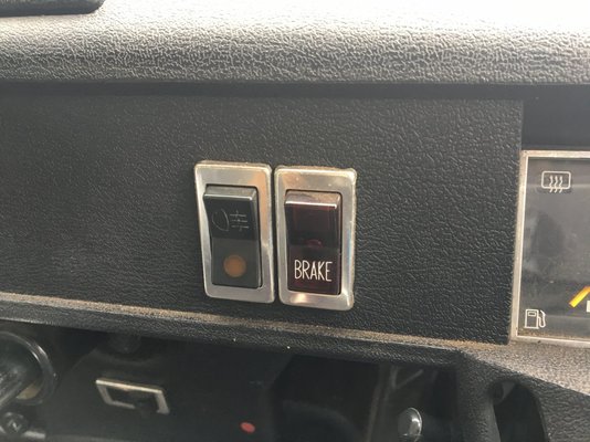

Hi this has probably been asked before but I cannot find anything on the search - what is the brake switch on the dash for?

Curious isn't it! It is a brake warning light, and the switch is only there to test the bulb. I think it is a creative solution to get through some legislation they forgot to design for. :-)
Only fitted to models with dual circuit brakes that have got a pressure drop warning indicator on the side of the master cylinder quite rare and these are the ones with 4 pipes coming out of the master cylinder usually 1977 to 1979
thanks for the replies - interesting - ours is an 1982. so i presume this illuminates when there is a pressure drop

It is a brake fluid level test wired to your brake fluid cap. It indicates when the fluid level drops in the reservoir and illuminates.
