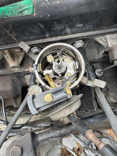

S SandraR Enthusiast Messages 25 Location Swindon Apr 21, 2026 #1 Hi all Can anyone help to identify the make of this distributor (see photo), I’m trying to find a new distributor cap and rotar arm… Thanks Sandra
Mjurin New Member Messages 1 Location Primosten Apr 21, 2026 #2 Hi, looks like Magneti Marelli. Found available rotor number VEMO V24-70-0025 and distributor cap FACET 2.8201PHT
Andy McGhee Enthusiast Messages 2,050 Location Cheltenham Apr 21, 2026 #3 Hi Sandra The numbers Mjurin has provided cross-reference to the ones I gave you.

Boretto62! Enthusiast Messages 19 Location Milano Apr 22, 2026 #5 Attenzione nel rimontare la calotta nuova Disegno appoggio
