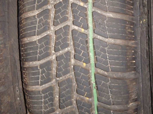

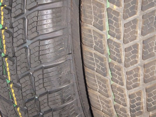

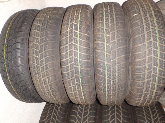

Here are my Barum polaris3 winter tires 135/80/13
First one is brand new as i use it as spear tire. 4 others are on the car.
This is how they look after one winter here in Dalmatia
