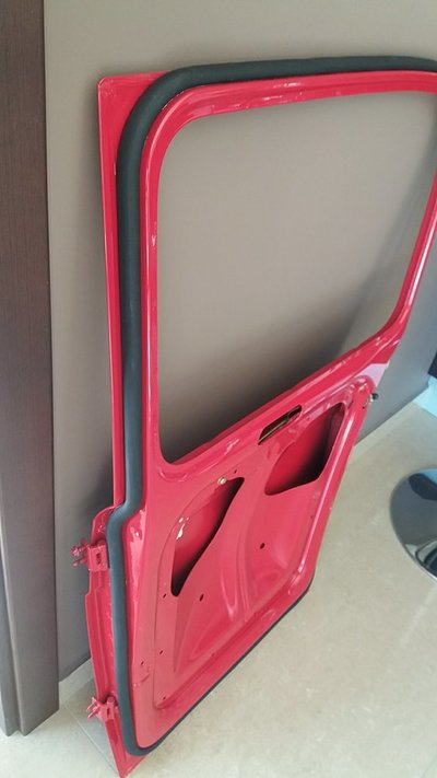

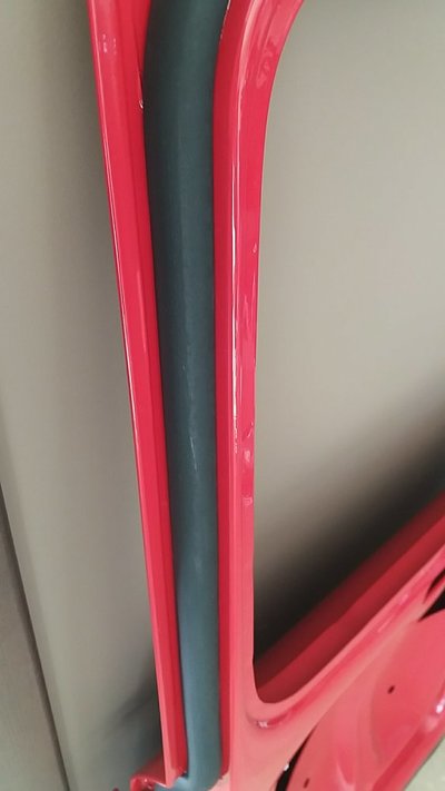

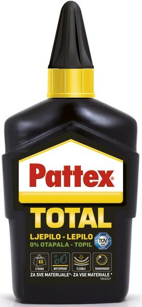

I have used "pattex total" and it worked well.
still holding after 5 years.
It is easiery to find locally then ordering from franzose

Hi, does anybody know how to get Pattex Total in the UK? I can only find a Polish supplier who doesn`t ship here.
Cheers Simon.
I can check it in stores localy and ship to you.
I am in Croatia so few days more to UK.
50g bottle is about 5 GBP+PP
If you want send me PM.
Pattex glues are available in France, if anyone there can have a look. It could be possible to have a group order and have box sent over.
I am about to do this job myself as well. I have found a product called Pattex 100% on sale - do you think it is the same thing? seems to stick rubber well.
Yes, it is. Total and 100% are the same product.
