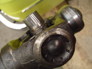

After deciding to dig out the R4 van I remembered another reason it had been put to one side, I'd nicked one of its good driveshafts for the white 4. I checked though the stock of noisy shafts to pick the best one out for a look. This was a 1200 mile old recond shaft that developed the rattles early on. I had bought the thing three years before using it so a return under warranty was out of the question, especially as the vendor had since closed.
Anyway, this shaft seemed the best prospect having the later type cast BED outer joint, and likely a decent internal pivot. The universals were removed to reveal why it had worn prematurely, the cups had been distorted when it was put together causing the needles to wear the universal prematurely, no probs I thought, I had a new set of universals. Just pop the old ones out, insert the new ones and off we go, too easy. Only then I discovered the R4 uni joints are smaller by about a couple of mills than the 16 ones I've got. Ah well back to the drawing board :-)
