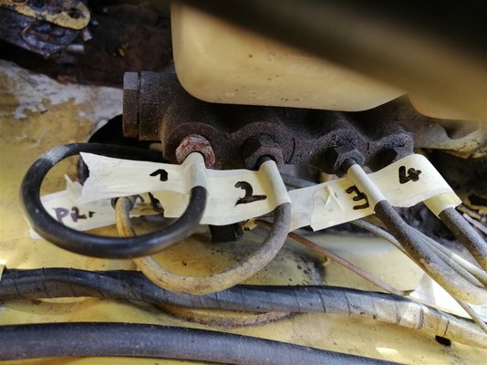

I have 4 outputs on the M/C and seemingly only three places to attach the pipes.
3x M10 and 1x M12.
One left wheel, one right wheel and the rear brake junction.
Where do the brake pipes go from the master cylinder any one please?

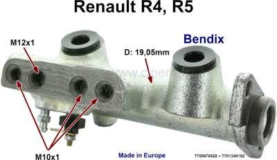

Some R4 master cylinders are three pipe outlet and some are four pipe outlet at the master cylinder end. If you have three pipes on your R4, the master cylinder in the image is not the correct one for your R4.
3 pipes = left front, right front and both rears
4 pipes = left front, right front, left rear and right rear.
Thank Guys, that make sense.
It just make me wonder why I have 3x M10 fittings and 1x M12 fitting on the M/C?
On cars with two rear brake pipes, one has an M12 union nut, presumably for not to be assembled incorrectly.
You can plug this M12 outlet and use the three remaining outlets for your existing brake pipes.
OK, Thankyou.
So the answer is, Plug the M12 outlet.
Use one M10 for the rear brakes compensator.
Use the other two M10 outlets for each front wheel.
