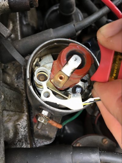

I think my distributor is an SEV - the white plastic piece blocks the hole to feed the wires through the body of the distributor
Small sized SEV dizzy. You can swap the dizzy for a bigger ducellier than it will take the electronic unit.
Easy swap.
