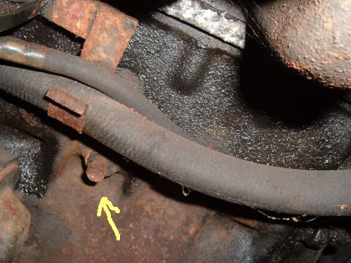

Now it is quite difficult to determine from were because the spot is quite unaccesible. It appears that (I am not sure) some water is leaking from a screw that is a little bit lower and on the right of the starter motor. It appears that water is dropping (aprox 1 drop every two seconds) from that srew but it may also drop from the pipe of the heating which goes to the water pump althoght it seems quit dry.
Any suggestions or have you ever encountered this problem ? Shall I try to tighten the screw or remove it and put some teflon?
