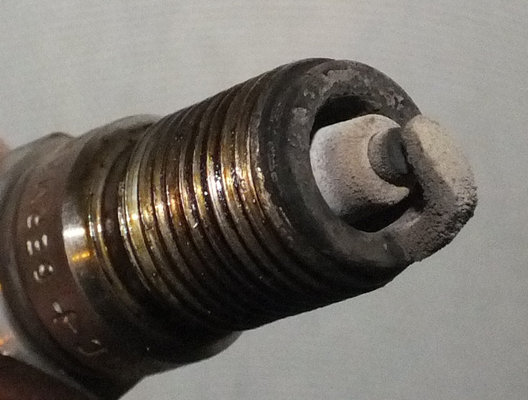

Might be worth a look then. :) The photo is a plug removed a couple of days ago after maybe 20k miles. Looks fine there but is more white without the camera flash.

It`s to white ( lean ) and therefore to hot... can cause misfire

But i would stil replace the sparkplugs and set the carb a little richer. Your engine is running a little to hot.

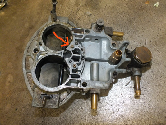

One thing I'm thinking is I have a tendency to blow out carbs with an air line to make sure all the jets are clean. The air control jets set into the top of the carburettor are very easy to blow out when you blow through with an air line. The smaller the air control jet the richer the mixture. Missing air control jets would result in a lean mix. Will need to check if any have blown out without my noticing.
Missing the air control jet, you would normaly have trouble to adjust your R4
The real influence of the air corrector on air/fuel mixture happens at the top end of the rpm scale, on lower rpms it's really a matter of the main jet and emulsion tube.
I think I've fixed it. The enrichment jet on the secondary choke was no longer in the carburettor top, but had fallen into the base and blocked the hole where the extra fuel should have come out.
Also the brass pipe at the bottom of the photo appears to vent the float chamber into the plastic intake duct on top of the carb. I've fitted a restrictor but am wondering if it should be blanked off completely. There is another vent for the float chamber at the top which closes on throttle.
It's now running happily at my more retarded setting.
