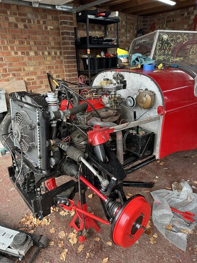

poking bent wire in did not yield any resultsSometimes there's a build-up of rust and debris immediately behind the drain plug. If you use a bent bicycle spoke very carefully, you should be able to remove it.
 I fear engine coolant channels might be blocked by rust. Really want to avoid taking cylinder head off if at all possible.

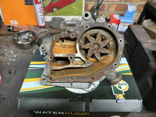

 I fear engine coolant channels might be blocked by rust. Really want to avoid taking cylinder head off if at all possible.Taking the cylinder head off is your only solution to clean everything by the looks of rust inside your waterpump.poking bent wire in did not yield any resultsI fear engine coolant channels might be blocked by rust. Really want to avoid taking cylinder head off if at all possible.

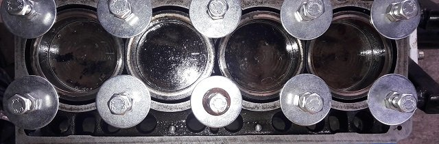

This was the "drastic" action to which I alluded..... Yup, if you can't shift the detritus by flushing then it looks like it's a "heads off" job. The advice included in the above post regarding securing the liners in place is vital and I'd recommend a careful reading of everything before commencing.... Good luck!Taking the cylinder head off is your only solution to clean everything by the looks of rust inside your waterpump.
Make sure to secure the cylinder liners after removing the head.

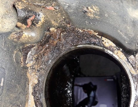

Here you see a typical build up of rock hard debris at cylinder 4 were the rear drain plug resides (I did a full engine overhaul so the liner is removed)
