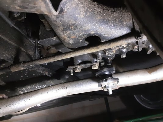

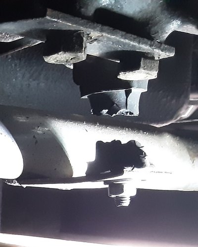

Our R4 passed its MoT today, but with an advisory about a broken exhaust mount. I can see the problem and have replaced ones like this before, but the way the pipe is fitted would put too much strain on a new mount. Are longer mounts available? Or is there another solution?
Thanks.
There's often enough room to put a thick washer between each end of the 'cotton reel' and the exhaust pipe/chassis mounting.
Thanks Andy, good idea, but I don't think that will be enough. The current mounting block has rubber that is about 25mm long, but the gap is over 35mm long. I don't think there would be enough thread to allow that.
you can get rubber bobbins at any good autoshop for nxt to nothing.cut them to needed lenght push a screw/bolt through Loose fitted with 2 nuts
and you're good to go.
-Choose soft bobbins (measured in Shores) to avoid loud resonance in body/frame Broom-broom..-R.
Mine need changing soon, have noticed that Piezas here do a reinforced one here, also note that they also stock an exhaust silentblock mount for Morris Minor, thread is bigger and block heavier, but look a good upgrade, sure they
must be available nearer than here.
