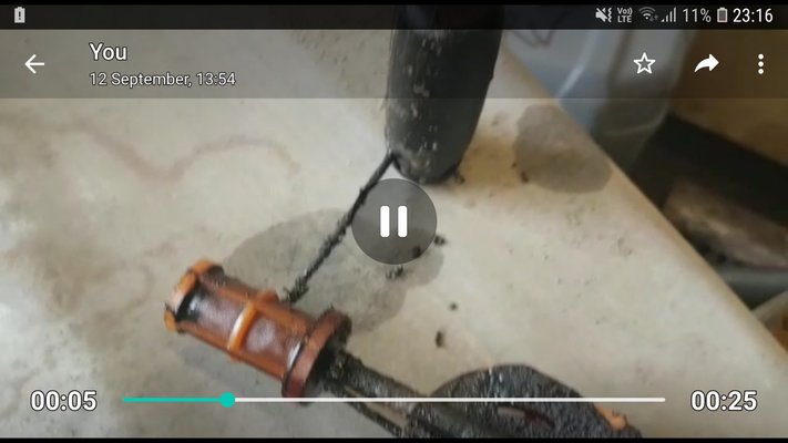

There is a filter on the base of the fuel sender unit as the pickup is through this unit these definitely clog up accessing it will mean removing tank

All - taking everyones advice we dropped the tank out and sure enough the sender was not that special and definitely the original! It worked slightly better with a separate earth though. I ordered a new pump and sender from Franzoe, changed both and it now runs like a dream. Interesting the replacement sender now comes with a separate earth.
