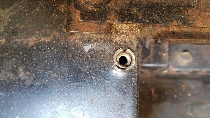

Andy McGhee Enthusiast Messages 1,812 Location Cheltenham Jul 24, 2020 #1 I'm not sure what these are called, but does anyone know where to get these captive (caged?) nuts for the folding front passenger van seats? Or ideas for a DIY alternative?
JdeW Enthusiast Messages 1,127 Location Laarbeek The Netherlands Jul 24, 2020 #2 Blind rivet nut, there are several types, picture beneath the folding example and available at any decent hardware store, at least it should.
