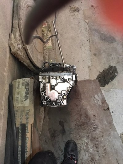

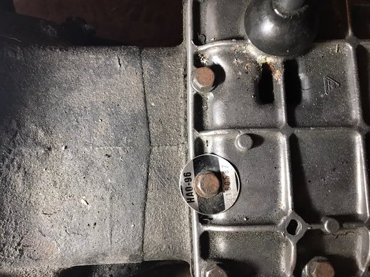

It seems quite common for the speedo drive gear to fail on 4s/f4/f6, they are a plastic cog on a metal spindle, so its probably an age related thing. They can be changed with the gearbox in situ in the car/van, basically support the gearbox with jack after taking of plate between chassis rails, (10mm spanner), take load off of gearbox mounts with jack, remove speedo cable, remove 4 mount bolts (13mm), remove mount bolts from gear box, (13mm), then remove front plate from gearbox, more 13mm, carefully prize plate off, your trying to save gasket unless you have one spare or ordered, iirc there is one shim that comes out with plate but its easy as it can only go back one place when you refit, the drive is in the white plastic plug thats in the front cover that the speedo cable goes in,remove plug, change drive, refit as it came off and youshould be all good. Do check your gearbox is the same HAO 96 (should have a disc under one of bolts on top plate of gearbox) as these cogs came with various teeth to suit gearboxes, heres two photos of my box out, one showing disc and other showing front plate. You don't have to drain oil to do this.E72C854F-66C8-4624-A745-C267766BCC52.jpeg910EB6F0-2645-4828-B5AE-0A2C0A3F63A1.jpeg

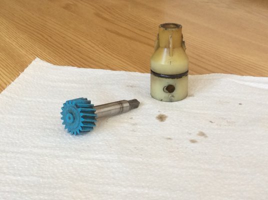

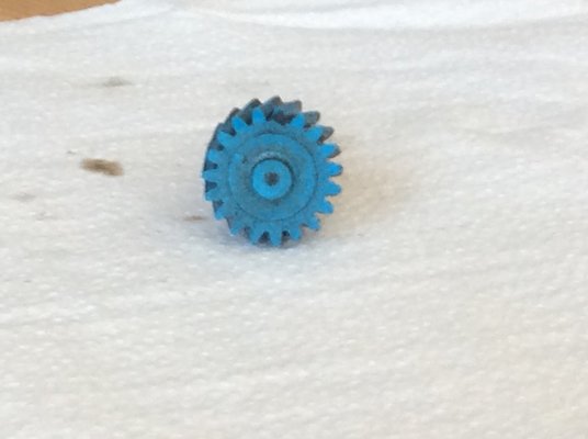

Is this the g/box from a F6 with a cleon engine ? My g box is h a o 163 , the drive is pale blue with 19 teeth , i am after a replacement
Dont know if you can help
many thanks .
Nigel
Yes it is a gearbox from an 1985 (fasa) F6 with a cleon engine, the cog is a pale blue with 19 teeth, just looking at old ITV’s it has been in van from new (genuine Renault part from DKS) for approx 8000kms, black mark on cog is just indebible pen mark to count teeth, the plug is gearboxes original.image.jpgimage.jpg
€40 plus post, was going to just use normal or registered post in a jiffy bag, there not big, can do this from local post office as currently carless, nearest parcel post office is 10km away, I am in Northern Spain.
