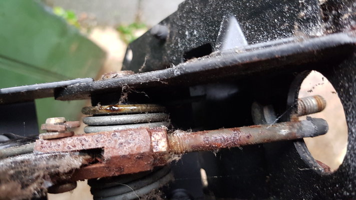

I've chekced that the pedal pushrod is correctly located into the piston end of the master cylinder and the pedal moves freely all the way to the floor/bulkhead. The only thing I can think of is the pushrod is the wrong length.
It's going to be a pig of a job to remove I guess as access to the pedal/fixing will be a nightmare but are there different length pushrods? Does anybody know the correct length for F6 R2370 as above?

You should feel when the rod contacts the master cylinder. When it goes from free travel to acting against something. Normally the free bit will be 5 or 10mm pedal travel.
For what it's worth, here's a picture of the pedal assembly from a RHD GTL with the same 3-port master cylinder. The distance from the outside of the nut to the end of the pushrod is 61mm.
