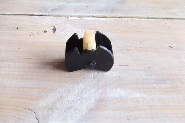

This is the underside of the button. The white plastic arm in the middle has a spring underneath so care should be taken when removing it.
The white plastic arm slots into the groove in the above brown plastic piece which in turn rests on the axles of the little wheels.

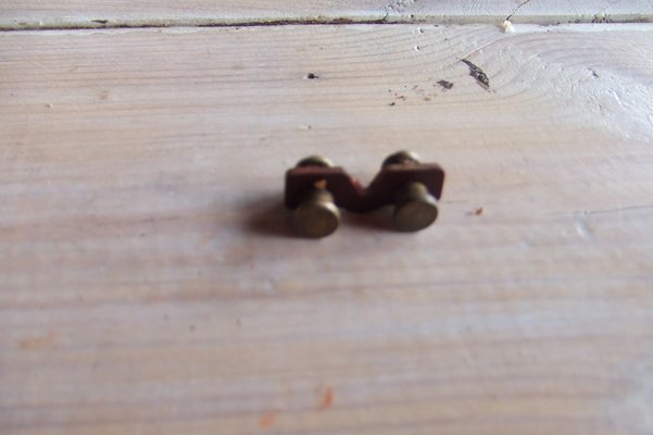

The wheels were very corroded
The contact points inside the switch were also corroded and dirty, but they are all fixed to the body of the switch and thus easy to clean. I used carb cleaner and ear buds and the tip of a small screw driver to clean them off.
All my lights, indicators and hazard lights now work perfectly so I think that this was definitely the problem.
