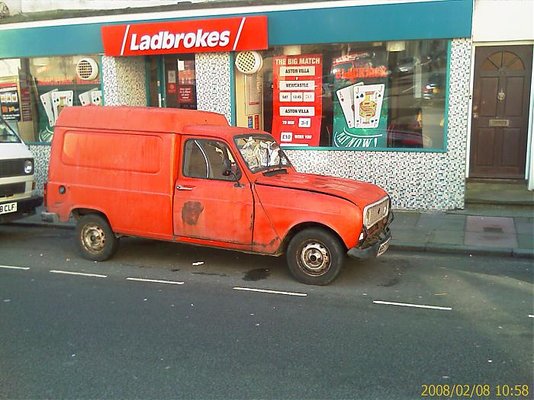

now this is avery strange coincedence as this morning i had to go and look at simon from brightons F6 van to see the results of a similar under bonnet fire
i was going to post pics and ask what was best way of cleaning extinguisher powder from carb that is now full !!!
damage is not too bad but no obvious cause of fire also ??
if carb which was new!! is u/s may end up breaking van :(

yes you are correct the air filter was being held on with a bungee strap as the carb fitted is off 1108 r6 (solex) and it is not threaded to take the plate that would normally take air filter and limited time last month meant no time for engineering
when it drove to my workshop last time simon had been using van with no air filter at all( and if you look carefully in [pics you will see Su electric pump on inner wing ) i was not happy especially as there was no hose clip fitted to carb inlet !!!!! yes i did fit one
fuel line is charred but not burnt through so unlikely cause of fire perhaps pressure was too high for carb and flooded ??
