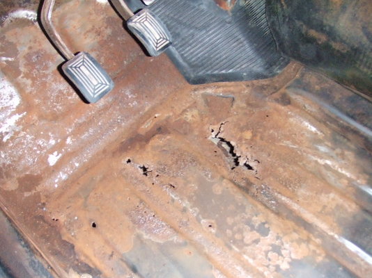

I've taken a photo so you can see what I'm dealing with. There's a big hole and then some little holes as well. I didn't even know it was rusty until my foot went through.
Would appreciation any suggestions.
You need to get the car up in the air and have a good look underneath and a probe around with a screwdriver. Repair is quite straightforwards if the hole is just in the floor itself, but if it extends under the side members, or into the toeboard area, then you need to review whether it can be properly repaired without a body off job.

Bear in mind also that the fuel line runs down the side member, before you starting sparking up your mig in that area.
Regarding the last photo I did read somewhere that this floor area isn't classed as structural so virtually any repair that stops your feet falling through is ok . Now as far as the "swages" or what ever are concerned I have seen floor repair panels on the internet that are just flat with no shaping so they literally slot into place but no mention of how they are fixed because it says easy fix . Can any slot in floor panel be pop riveted in and then underneath just be under sealed .

If you're interested in how I eventually fixed it, here's the link. The repair is over 5 years old now and still perfect and strong.
In answer to your question, personally I would say that if the rust is chemically treated and sealed then you could use pop rivets and seal the underneath. Possibly, it's only a temporary solution like mine, but if it lasts for many years I think thats ok.

I live in France, and as you know the whole of Europe has become very strict lately. Last year I was failed because I had a tear in my seat cover. My car has had at least 3 MOT/CT tests since I did the repair to the floor and it's passed each time.
I smoothed off the sealant underneath really well so the repair is hardly noticeable.
I think a welded panel is definitely better and more professional and I even bought a Mig welder but I seem to burn holes in the metal all the time, so I'm a pretty useless welder. Maybe one day I'll get the knack of it:)
