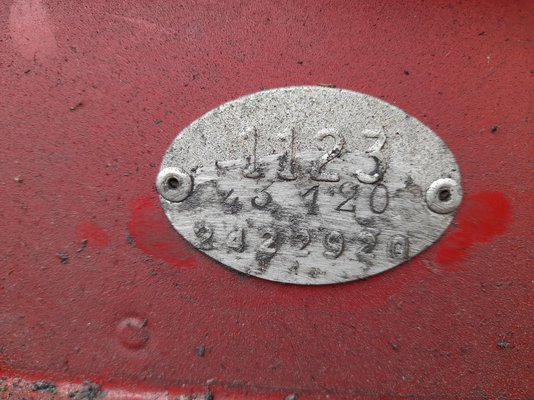

Is your R4 a late TL (112C on the oval plate under the bonnet)?
Does your system look like this?
Apologies for being so sloooow to get back to you_this does very much look like the exhaust system under my car, and the number on the oval plate is 1123, the number 3 could correspond to the third letter 'c' in the alphabet as the car was fabricated in Poland. It'd be a huge help if you tell me their significance. I now need all 4 parts of the exhaust (I had it sleeved last November). Thank you for your patience, kind wishes, Julia

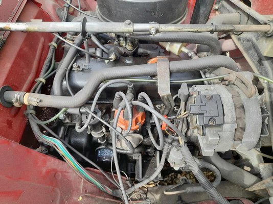

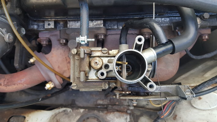

The fact that it's an R1123 makes it difficult to be sure which system the car has. It'd be helpful to know what type of engine you have - there's a plate on the right-hand side of the engine, just above the oil filter. Some underbonnet photos would be great too!

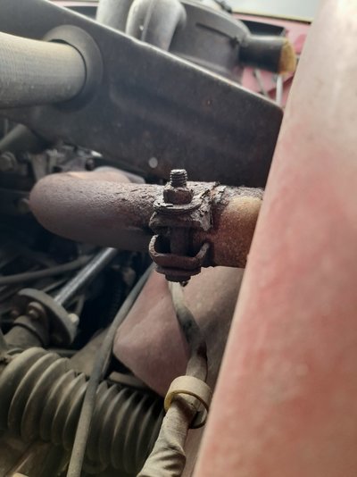

You mention a clip between the manifold and the first pipe - this made me think your car might have an 845cc engine. Does the clip look like this?

No, it's like a giant jubilee clip ( could it be improvised ?), here is a photo.
It is also possible the chassis/body/ engine are not original.
I imported the car and the V5C states 1108.
Thanks for the photos.
Which bits of the system do you need?

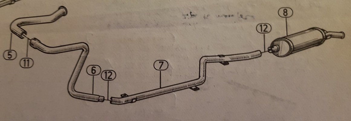

To complicate things, there are two different systems - although both have the same first pipe (the one that connects to the manifold - 5 in the diagram below) and silencer.
The part numbers are:
5: 7700578443
6: 7700657468
7: 7701365697
8: 7700859523
This is the system that the parts book gives for cars with engines like yours up to 1985ish; the later system has different numbers for pipes 6 and 7:
6: 7700757174
7: 7700757178
I can't be sure which system your car has.
The long pipes are getting hard to find in the UK. The easiest - but most expensive - way would be to order a complete system from, say, Der Franzose, but you might find the pipes on eBay. You just have to make sure that pipes 6&7 are the right ones, and that, ideally, they're made by the same manufacturer.
5: 7700578443
6: 7700657468
7: 7701365697
8: 7700859523
6: 7700757174
7: 7700757178
I can help with pipe 5, if it helps:
The clamp you mention is easy to find a replacement for - most people use U-clamps, which are widely available (try eBay).

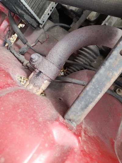

The link I sent you was to help in identifying your engine - that clip is for the small, 'Billancourt' engines - not suitable for your car. Your engine is a 'big' Cléon engine - on these engines, the first pipe is connected to the manifold with a captive clamp that fits over the manifold studs. This should look familiar:
You should be able to reuse the clamp - once the 'S' pipe is removed, the clamp will slide off the end of the first pipe.
The fact that the number on your oval plate is R1123 is potentially confusing - you'll end up with the wrong parts if you go on that number when you search for parts. Most cars with an 1108cc engine will have R1128 on the oval plate (GTL).
