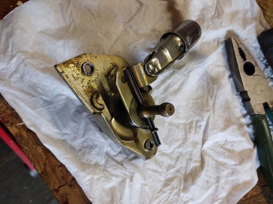

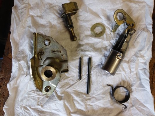

Hi Karen, what's wrong with the old one? I recently had to replace the 3×50mm roll pin, as the button didn't work, but I could open the door from inside. I found some on eBay, but if you need one I could send it to you if that helps and is what you need, as I have some spares.20210610_093506.jpg20210610_102035.jpg

thankyou so much - this looks like what has happened to ours - but not being mechanically minded I will have to get our local garage man to fix it. He tried a weld! which broke - i will send him your photos if I can.

Ok Karen, let me know if I can assist, but your garage man should be able to fix it for you.
