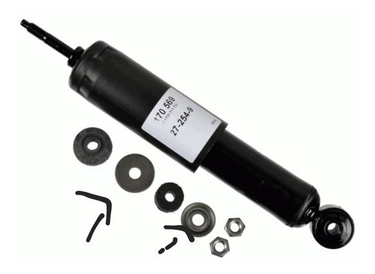

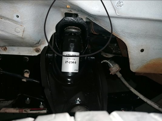

Hi all..
My new front suspension brings 2 new rubbers and 2 new washers (different than oldone's) with the old washers the rubbers don't fit well.. anybody could please share a picture of this.
Why don't you fit the washers that came with the new shock absorbers?
@angel the new kit only brings 2 washers and 2 rubbers
Is this more than enough?
It just omits these two washers between rubbers and chassis.
Fit the flat washer on the shock absorber, then fit the large rubber with flat face towards this washer. Fit the shock absorber on the car, then on the upper side of suspension upright fit the small rubber followed by the cup washer, concave side towards rubber.
