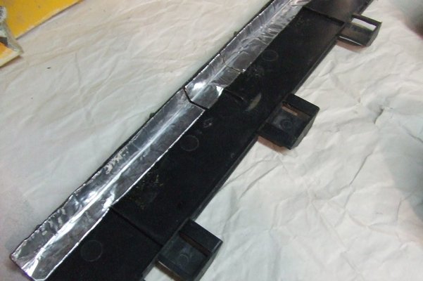

My heater works well and after 2kms it's warm inside. BUT, my fresh air vent is broken. I fixed it once before but it is again broken:dontknow:.
So now my hands on the steering wheel stay cold:o

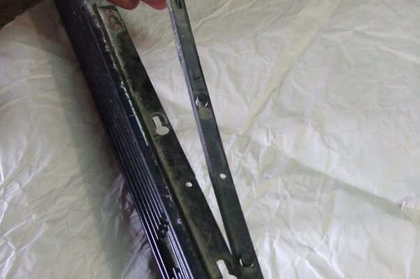

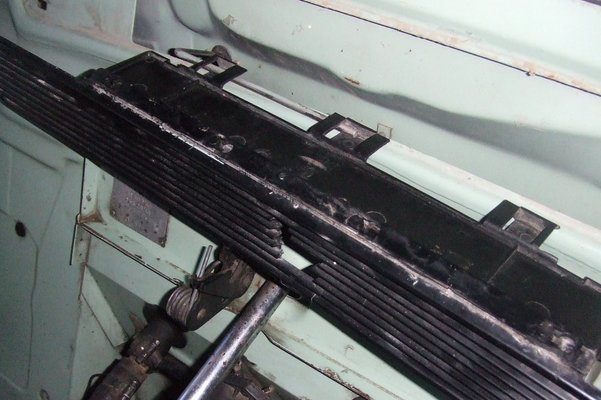

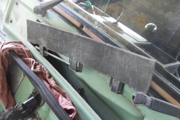

Yesterday it was -1degree when I went to town and my hands got very cold again so when I arrived back I decided to fix the flap. Only afterwards did I see your mail. Here are photos of the repair.
i used a roofing material which has bitumin on one side for adhesion and silver material on the other side. If it breaks again I will accept your offer
