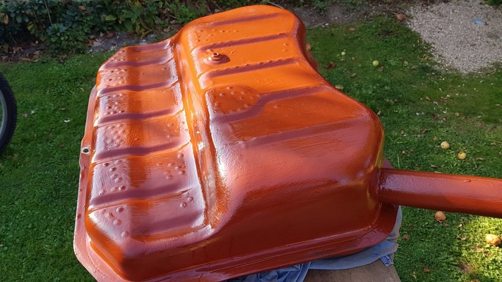

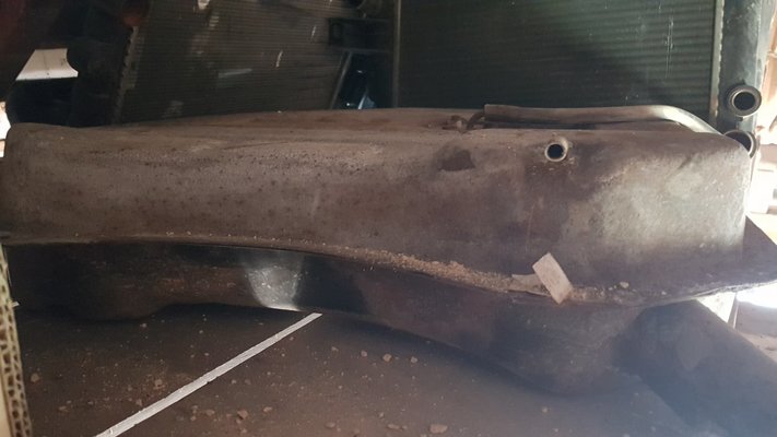

Probably 34 litres (if the tank looks like the first photo). The earlier models had a 26-litre tank, which is a flatter shape (photo 2).
