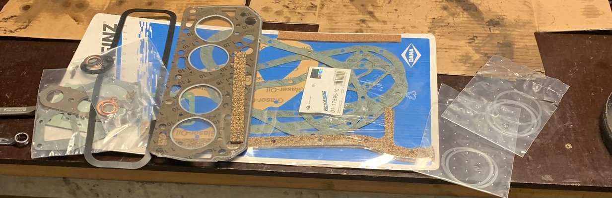

Bought gasket set brand Viktor Reins.

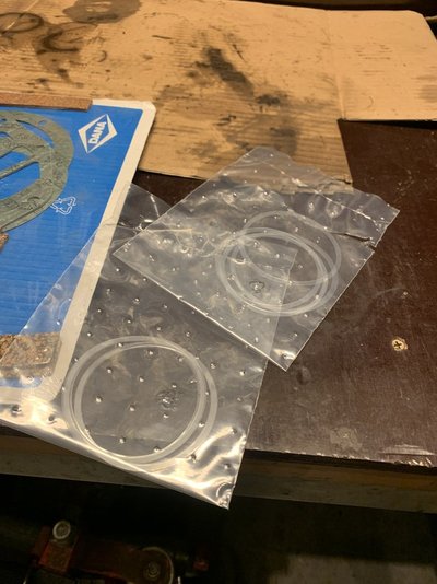

Everything looks good except cylinder shim/gaskets are not paper typ but in some plastic material see picture.
Anyone have experience from this type of cylinder shim/gasket.

"Paper" seals were made from a material Renault called Excelnyl. As long as these seals are some 0,1mm thick (not 1mm as is the case with earlier copper seals) I would use them. Reinz is a trustworthy company after all.
I also feel Reinz is a ok brand but get a bit confused though the shims is plastic.
I try to fit them same manner as the paper gaskets.

I have also bought plastic paper gaket for cilinder liners. Had same question about them but guy that works a lot on r4 engines said he use them also and they are alright. I chouse to belive him and will use them when engine rebuild is on schedule.

Gasket shims for the liners I then use what Reinz provided.

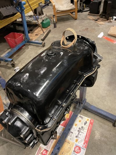

Still my first Renault engine rebuild so have some questions about the sump gaskets.

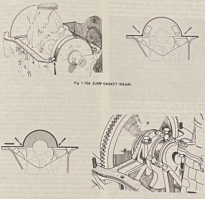

Seem to me that the front sump gasket is totally wrong in size, guess I have to cut it down so it fits inside the growe closest to the flywheel.
The cork gaskets are they installed dry or you use Permatex on one/both sides?
Where gaskets meet in 90^ angle i put tiny sealant in

After lots of swearing and fails trying to persuade both cork strips to stay in place, and adding the fact that both of them are almost invisible with engine on car (so that I couldn't see if they were in place when the sump was back on), I threw them away. Instead of them I used a thick - around 5mm - and uniform bead of good RTV sealant (Permatex Supra Black or Grey is excellent), keeping the side cork gaskets. Worked a treat on 3 or 4 cars I have used this technique.
For side gaskets I use a sealant like Hylomar or Indian Head.
Be aware that you should first fit flywheel, then sump!
Thanks fore sharing your experiences and remind me about put on flywheel first (had put sump first otherwise) thanks.
I will try put gaskets the way it's done from factory, so I will cut down the oversized one to fit the cavity on the flywheel side. There is a lot of tricks how to but not for Billancourt/Venteux sump.
- some say put the cork in water to make them flexible.
- some say spray glue "against block side".
- some say use old school permatex and silicon in the 90^ gasket junktions.
I guess a lot of you have made this how was your way to succes or misery?
It seems that modern gasket sets have mismatched parts...either too wide like yours, or too thick, which was the case on some sets I got. Problem was that front and rear sections would not allow the sides of the sump to touch the side gaskets wihtout having to deform the sump by overtightening...that's how I decided to use RTV.

Gaskets and sealants are a bit complicated or very easy dempending on approach.
I try to use the proper technique to the application. Modern cars are often RTV based technology machined flat to flat surface.
When working on Porsche engines from 1960-90 we use at least three different seals (Trebond 1211, CurilT, Loctite 574) they have also machined surfaces that should be glued and/or sealed.
None of above is supposed to use with cork gaskets. And the Billancourt is designed with old tech sealing. Machines surface to tin sump that have some flex and imperfections. I think when engines where new from factory they didn't leak oil. They had better gaskets and the correct sealant. So I want to go old school and want advise to do it as good as possible. If it don't work out I also go RTV route.
If I do everything right it should work.

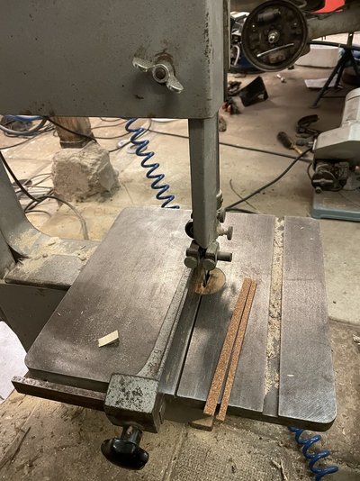

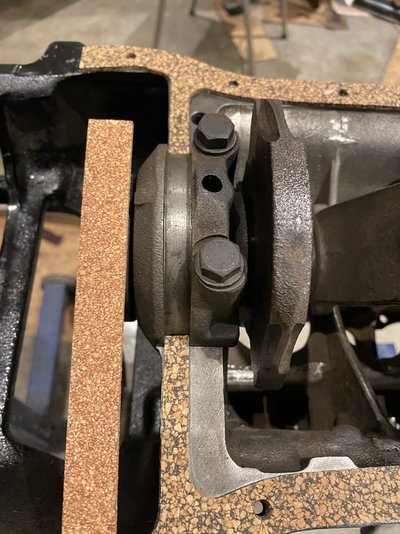

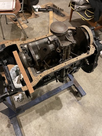

Cut down the cork gasket that was way to big in my bandsaw to 10x138mm then I put gaskets that should be installed in a radius in tension to make it easier to use them.
Haven’t made up my mind how to install them yet
