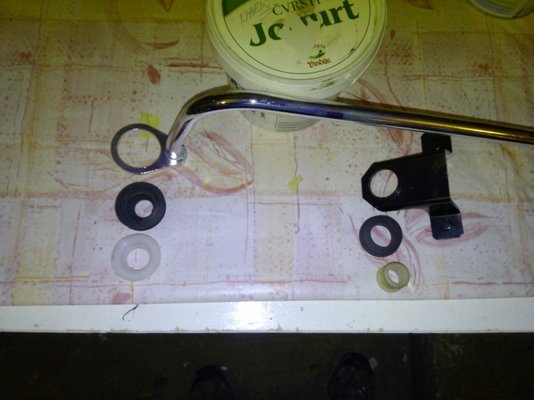

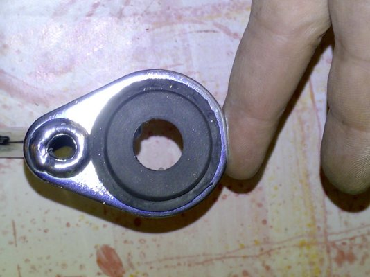

Hi guys, after struggling to fit a new grommet and bush, and it only lasting a year before the rubber grommet started splitting, I did this little mod.

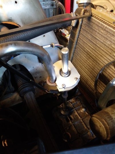

Spherical bearing held with two aluminium plates, and using the old grommet, modified to centralise the bearing.

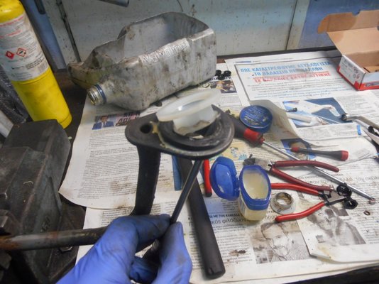

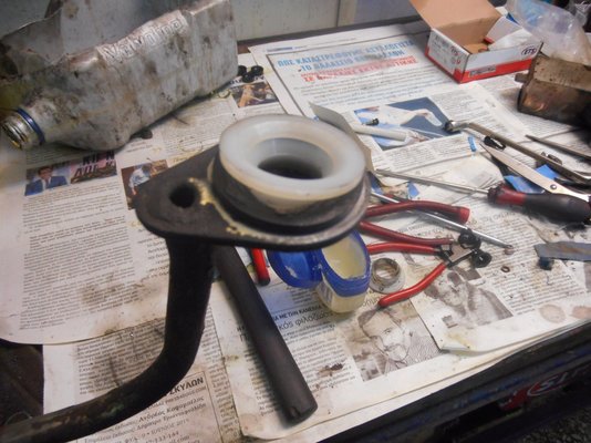

I did the same, but designed a plastic housing for the bearing.

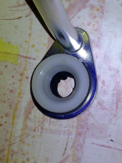

We have two images here.

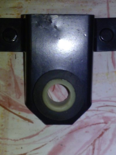

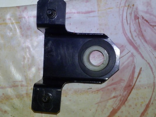

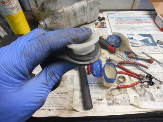

This from post #12 seems to show the bush inserted from the top

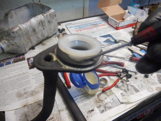

But this image from post #18 shows it inserted from the bottom.
Which is correct and does it matter?

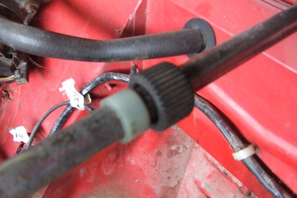

Thanks. That looks like a tricky job.
I was rather hoping to do it "in situ" but I guess not :vsad:
