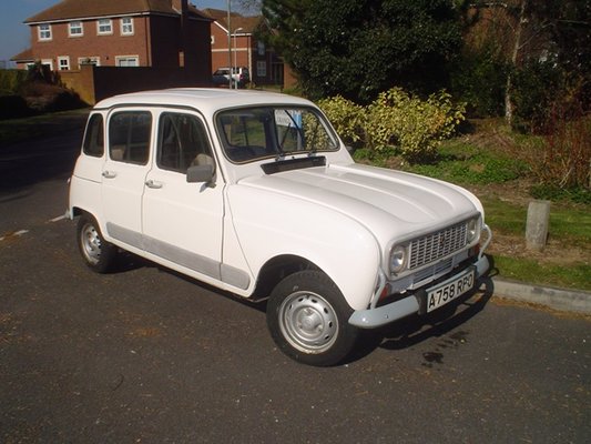

I have bought a tidy 1984 GTL through this Forum ,although I have not yet seen it.
It was inspected on my behalf by the RCCC chairman who reported that the bushes on the gear linkage were worn.
Can these be obtained or is there a work round.
Thanks Gary

That looks like a good find - no rust peeping through in any of the normal areas (unusual for an A reg car - rust proofing was improved on later models).
Well worth having a look before buying any parts - a nasty gearchange is often caused by the spring being missing from the gearlever, and the shaft does need to be lubricated where it passes through the bush above the radiator as Le Champ suggested.
