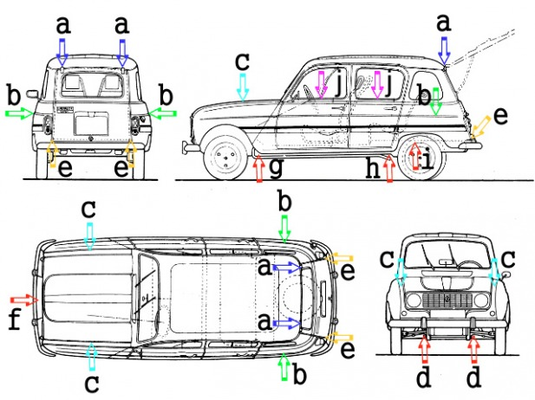

The well known rust spots of a R4
a. The hinges of the tailgate, these are welded with copper and can also cause corrosion due to frequent use.
b. Rear screen edges, if corrosion can be seen here, then the screen needs to be renewed and also the mounting edge, filler ex. is useless, also look inside the car remove the rubber over the curves of the inner rear screen and the points of the attachment of the rear seat belts.
c. Mounting edges of the front screen, when you open the hood you see three bolts with which
the front screen is attached, these edges can be very bad due to corrosion, cause sealed and never cleaned so that the wind could not do its job.
d.This is the front chassis, this is an important part, the front wheel suspension and the steering are attached to it, there is a tube running from left to right at this height, at the bottom there are often holes.
e. Pillars of the rear body where the tailgate closes, in the corners on the left and right the pillars are welded with copper, which can cause a lot of corrosion.
f. Front supporting beam, this beam provides reinforcement of the front chassis and also supports the gearbox on this, where corrosion can occur due to stone chips.
g. The front jacking point on both the left and right is often very bad due to corrosion.
h.The rear jacking point where the arm of the rear axle also rotates (swing arm attachment) is also often corroded.
i. The rear beam on this part is the rear axle mounted due to the double plate used by the factory, moisture can get in between and this also causes a lot of corrosion.
j. At this height of the windows you often see corrosion because the water and sand can get in between.
k. Due to spillage during topping up of brake fluid, this will get on the front left chassis beam and will rust through if not cleaned properly.
No doubt there will be more points, but these are very important ones.
