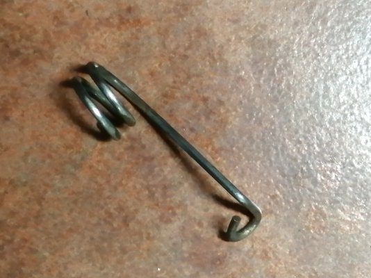

Ricardo Almeida Enthusiast Messages 19 Location Braga - Portugal Aug 31, 2019 #1 Hi, everyone! Can anyone enlighten me as where this spring goes? When I dismantled the handbrake cable, it was hanging loose near the right drum brake. Thanks for your time. Mola Susp Cabo Trv Mao 1.jpg 153.9 KB · Views: 0
Bobble Enthusiast Messages 546 Location Rutland Aug 31, 2019 #2 Hi, i assume that it has a hand brake operating on the front wheels, if so there should one fitted either side on the chassis just inside at the front, if memory serves me right it fits to one of the bumper bracket bolts.
Ricardo Almeida Enthusiast Messages 19 Location Braga - Portugal Aug 31, 2019 #3 Yes, its a front wheel operating handbrake. Thanks for your help.
mr-reno-139 AKA Paul Cunningham Messages 2,273 Location lancing west sussex england Aug 31, 2019 #4 Some early cars had this on front crossmember gearbox mounting bolts
