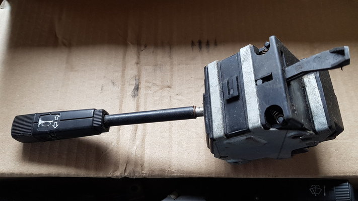

Sorry - should have said on 83 and later models with this type of switch:20210402_110545.jpg

Thanks Andy, I thought it might be something like that, but It's not working on my car in either configuration. What could be wrong?
It'd be worth taking the switch out and checking all the connections. Good luck!
Thanks everyone for your posts. Mine is a 1989 car so, reading the posts, this should work. I'll have a good look at the switch (after it's gone through the MoT on Tuesday). There's a problem with the indicators not cancelling reliable so I can tackle that too.
