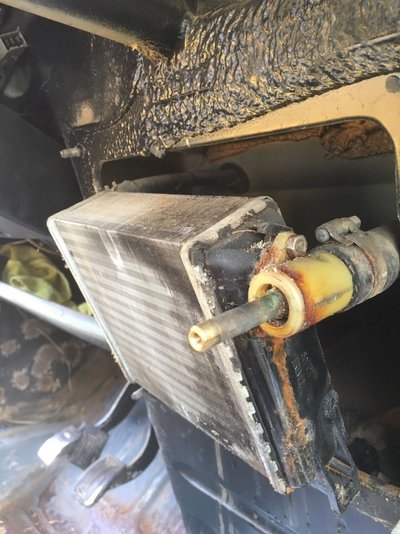

Update on Heater Matrix (Rad) leaking: 2016-10-21-PHOTO-00000006.jpg
So have arrived back and taken out heater Rad. On close inspection, it appears as though the actual leak is coming from the Hot/ Cold tap that allows the flow of hot water from the engine to flow through the Rad. (see pic showing brown stain of water from tap) i think the actual Rad is OK. It is the original incidentally as it is stamped with a production date showing month and year (Same as the vehicle). Rad looks in pretty good shape internally and externally not much crud came out of it (well have been running with the correct inhibitor anti freeze for the last 18 months at least anyway) but the little "tap" or open/close hot cold is only a plastic shell with what looks like a copper or brass internal key-way to allow the water flow. I'm guessing the plastic housing has given way over the years to continual heat change and worn slightly for water to dribble past.
Or........... the dribble is coming from between the "tap and the rad housing" as there does not seem to be a very good seal or gasket between the two ?? so do I take a chance and try to use something or a product of some sort to make a gasket.
Any advice would be well appreciated
Thanks guys.
Andy McGhee
1,532
Cheltenham
Your best bet - assuming the radiator itself is sound - would be to replace the tap and gasket. The taps come up fairly frequently on Spanish eBay; I'm not sure whether they come with a gasket. If not, it's a fiddly but straightforward job to make one yourself - the last time I had to do this job, I made one from some surplus water pump gasket material. Be gentle with the nuts and bolts that hold the tap on, though - it's easy to damage the heater unit.

Are you shure that tap is plastic?
Mine is all brass. I have open it and change o-ring inside and gasket between matrix and tap (at the end have put gasket made of water heater rubber hose), and works fine.
You can try to repair it. Wont lose anything (as you need to change it anyway) but can win much.
You can see details in my topic. Page 15.
Here is link
http://www.renault4.co.uk/forum/threads/what-have-i-done-r4-gtl.3996/page-15#post-49931
Hope it will help you

Hi thank You Petak,
I have found both a Plastic And brass Heater Tap On The Spanish Ebay. So will buy one now and replace, hopefully my problems will be resolved.
Great Andy thank you, have followed your advice and found a Tap on the Spanish eBay. Will purchase and let you know if all is ok! Thanks again.

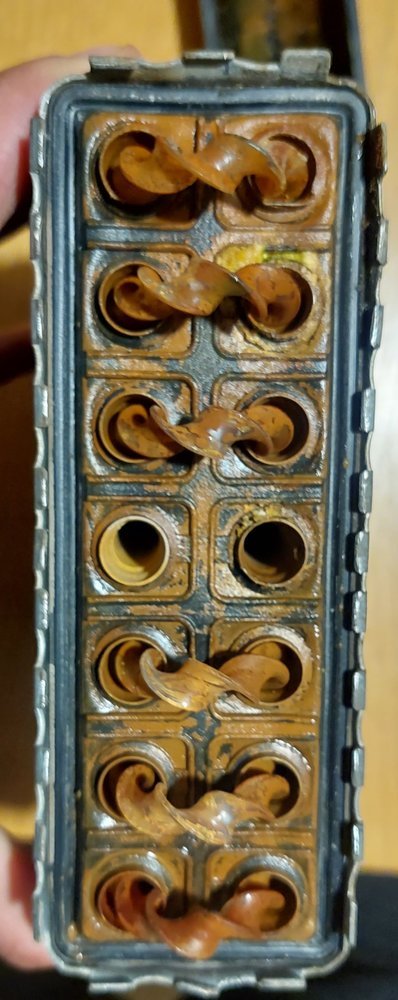

A internal pic of an heater matrix.
An old mechanic told me this "serpentines" retain the hot temperature in the heater and produce more heat.
