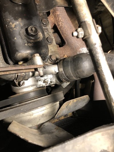

Hi all. Whats happening here please
edwin
978
Lichfield

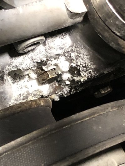

There does not appear to be a leak, but these crystals form in about two weeks. I have scraped them off before and washed the metal back to clean with warm water, but it has returned. There is no antifreeze in the cooling system yet, just water. But the stuff is dry, and no sign of water or liquid. Any ideas. Its in the garage, no draughts, electric green house heater under the car. Car runs nicely.

The forming of this residue is quite common on R4 water pumps. In the winter in particular. However, it would normally form all over the pump. I think it is due to a build up of condensation. Something similar can occur in a localized area due to a leak. The tell tale sign is that it would be a bluish colour (same as the antifreeze). It looks like a new pump and the residue is collecting around that bolt, check for a tiny leak from that bolt.
I've seen this before on other cars and it was from a very fine spray from the end of a hose when the clamp which appeared clamped tight. No dripping or telltale signs of leak, just crusty evidence a distance away from the actual leak.

There is Dissimilar Metal Galvanic Action the going on here.
Aluminium and Ferrous causes electric current just like the cathode’s on a Battery.
You have explained (I think), there is no antifreeze installed.
Glycol RX not only protects against frost expansion, but also was designed by Renault to protect their marvelous Cleon etc engines.
Get some Green in.

That sounds very interesting. The salts do indeed look like chemical precipitation I’m their shape and texture.
Who makes Glycol RX ?
Morning Edwin.
It’s Renaults own, but most modern Coolants contain inhibitors because of Aluminium and Ferrous parts within the System.
Renault developed their Coolants as the Cylinder Piston Liners formed the ‘water jacket’ and then interfaced with the Aluminium Head.

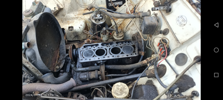

For others commenting I did indeed use flushing agent when car was in pieces with instructions to drain once 100 miles complete and complete flush and refill with with antifreeze mix
I have actually had head skimmed new gaskets radiator and water pump but the steel block was heavily oxidised internally and ideal solution would have involved removing engine and completely stripped and rebuilt but well over available budget
