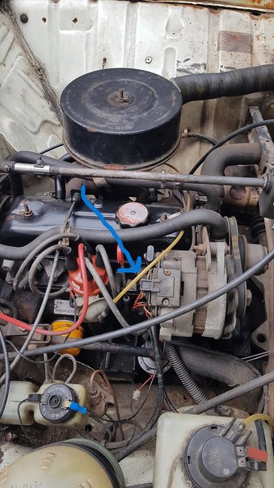

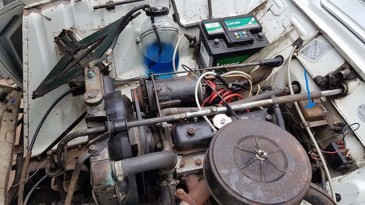

My F4 van has an issue where the idle increases when the car gets hot and I'd like some help diagnosing the issue.
I had problems with a stuck choke cable and slack in the throttle cable. I replaced the choke cable and took up the slack in the throttle. These solved the high idle issue generally because the choke valve now opens up, but when the engine heat increases after a few minutes of running (particularly in traffic), the engine idle increases with it. The mixture seems far too rich when this is happening and it's like I'm Saddam Hussein gassing the Kurds with my exhaust gasses in traffic.
I've seen various threads about similar issues - it seems it can be due to fuel getting too hot before entering the engine and/or due to vacuum leaks. I think the engine may be getting a bit too hot generally so I'll change the coolant just in case. I'd appreciate any feedback because carburettors remain something of a mystery to me.
