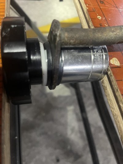

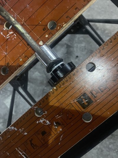

Finally got round to it. Used some snipe nose mole grips locked on the gear stick and wedged the handle on the top LH radiator support strut. Quite a lot of pressure anti-clockwise and the gear handle moved. Changed seals, a total giggled - I wonder how it was done on mass production in the factory? Below I show 2 photos of attempting to press the new plastic bush to the new rubber seal. Note the socket and oil filter removal tool are exact (correct size) and the press is square. You would think it would press in - look how far together they are clamped. However, as I unwind the workmate the bush just comes out. The only way I could manage was following the online advice of a small flat screw driver blade and some swan necks - unbelievable, 2 hours of my life I won’t get back

Next time remember to dip the rubber part in boiling water for a couple of minutes. You will be amazed by how much softer does it get.
