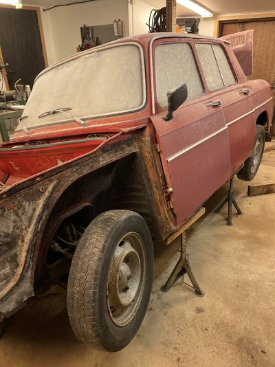

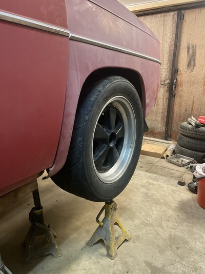

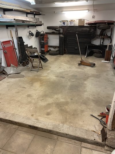

After winter prep and tidying up garages she got inside, she rolls easy after some air in the tyres but my plot is leaning so it's uphill. Some lifting with jacks and wood pieces under the wheels make it level I could push her in.

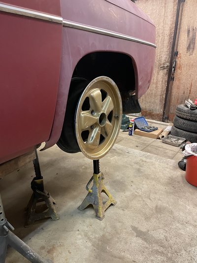

Blowed her as clean as possible from snow, then high up on jack stands demounting wheels. Leaving her with the lights on (600W as heating) over the night so hopefully she is dry tomorrow.

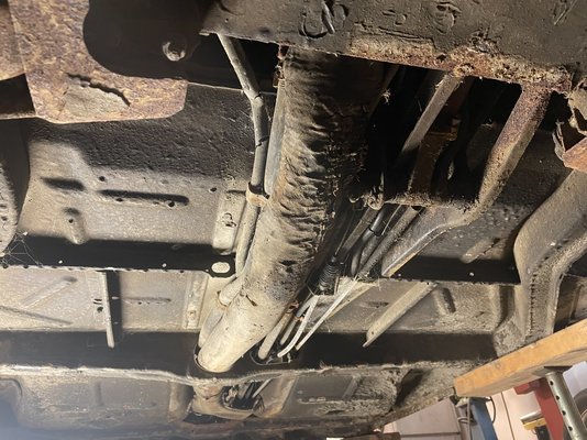

Anyhow some progress have occurred. Car is dried out and gone through with vacuum cleaner and compressed air. Wheels, fenders demounted. All open/hollow frames blown clean from dust and gravel.
Cos car is sold new in Sweden it had rustprotection since new. Most of the structural body is in good nick, there is rust that need attention but it's in some places not throughout.

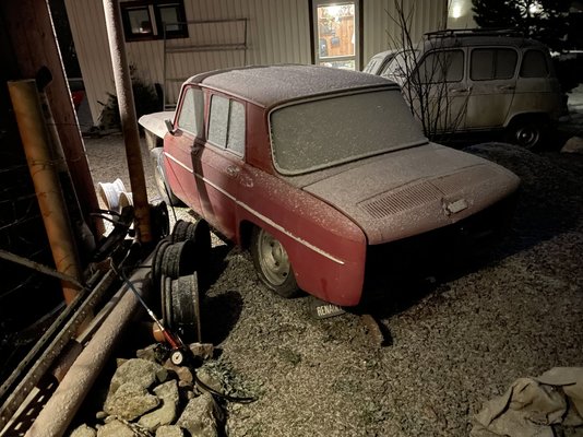

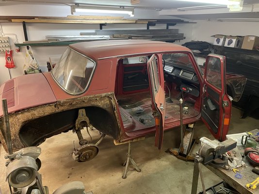

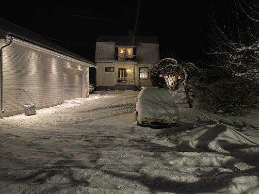

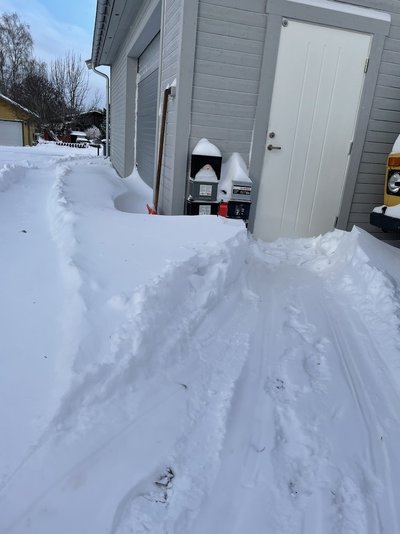

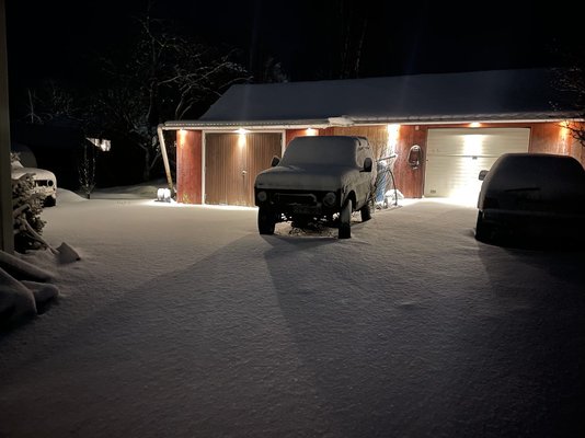

Cold and lots of snow made garage day shorter. -17*C and 12"(30cm) snow and windy day starts moving snow a couple of hour, then my father calls and says he need snowchains on his farm tractor. So we put on a 50kg snowchain on each rear wheel. He makes a test drive and everything is fine.

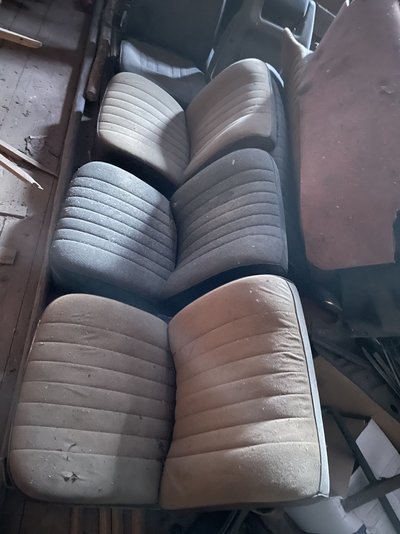

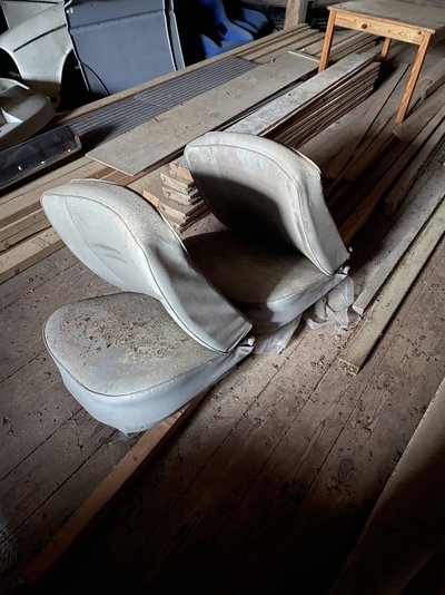

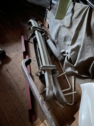

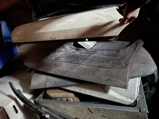

When at his place I check what spares I have at his place, think I found six front seats and one rear, some bumpers and fenders so it seems most parts are in stock.

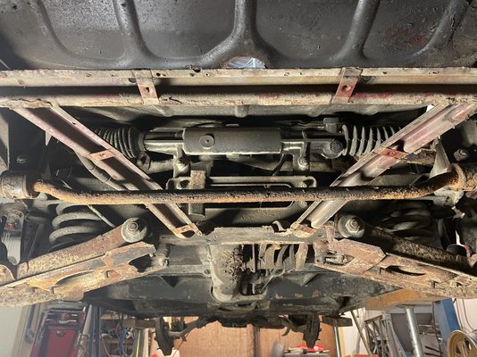

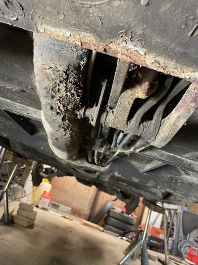

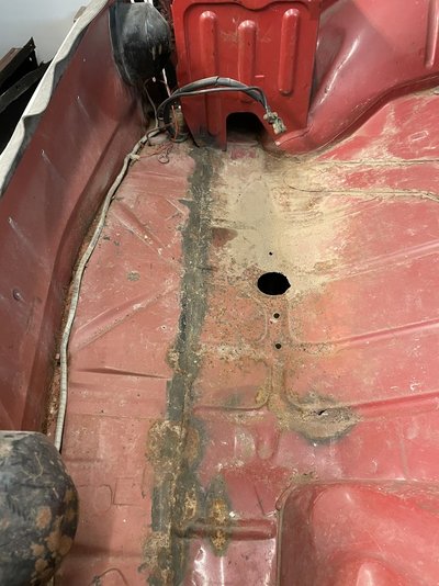

Start checking the electric and also that looks promising, body wise she also looking good, floor, sills ,doors, bonnet ,lid, fenders, boot and engine room looking great.

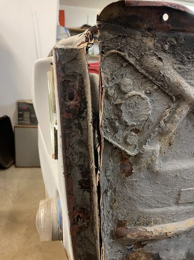

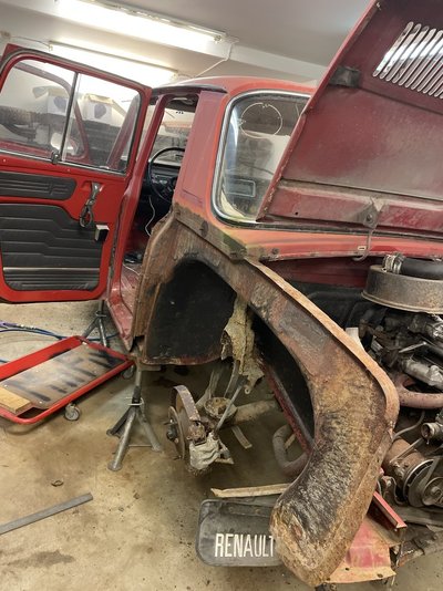

Front to innerfenders needs some attention, same with rear innerfenders and the lower C-post. Under the floor one crossmember is parscially rusted.

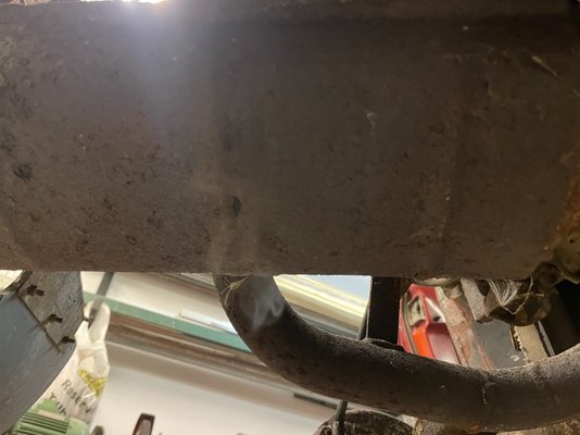

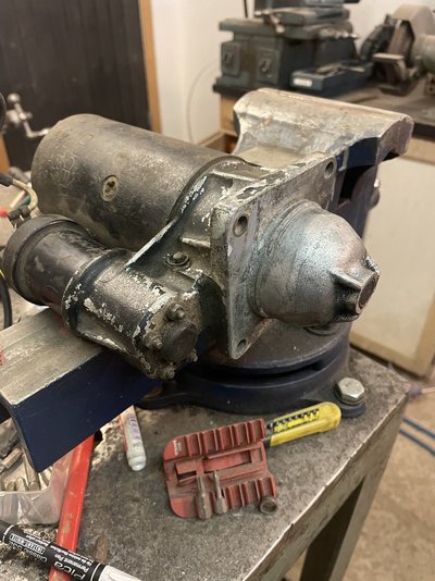

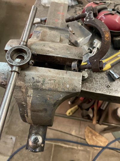

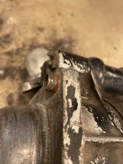

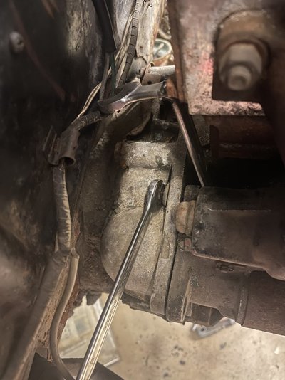

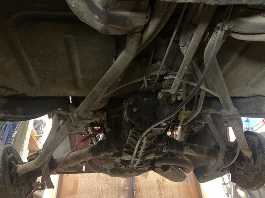

Unhook batterie and start demounting starter, the day before I already took of exhaust and undertray. Easy to bolt it down until I realised it's three bolt holding the starte not two. Third one nut is easy to see and reach but the bolt I tucked away between solenoid and engine block. Have no purposed tooling (C-shaped startermotor spanners) but my very versatile cut and 90 degree bent 13mm managed to hold the bolt.
Starter out so try feed it directly from batterie, still no reaction. Hit it in the flor some whacks and lot of black dust comes out I guess carcon and rust mixture. Test again, still no reaction.

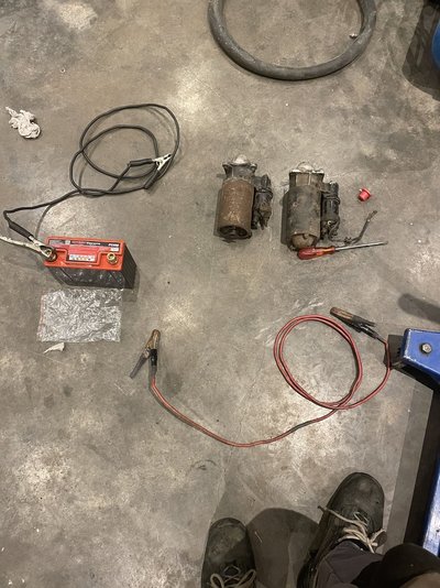

Two year ago I had time to sort all R8 parts a bit, remember it was at least one extra starter motor in the boxes.
Down to the big garage and pull down all R8 gear from the pallet rack. As mentioned before, previous owner had bought new and old parts to restore the Major.
Find two starters in the boxes, one very similar one a bit bigger. Hook up the smaller of the two to a batterie. Solenoid clicks and startermotor spins YES!

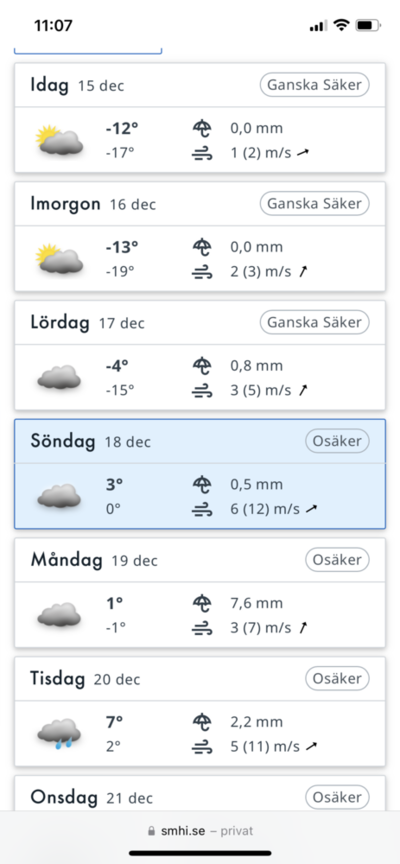

Still terrible cold here! Sunday it seem to be nicer temperatures.

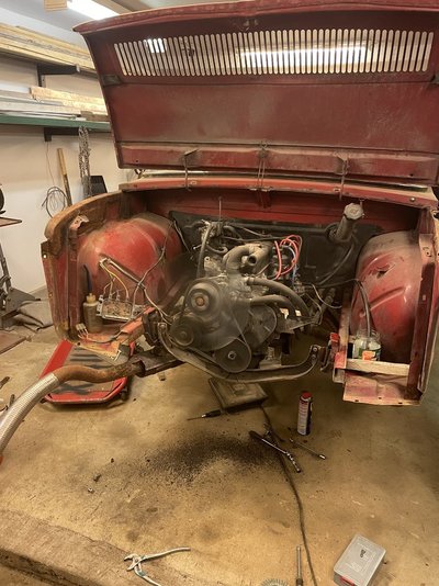

Some progress have been achieved, starter I found that was working hade guide pin on one mounting point, gearbox wasn't prepared for this, angle grinder have to sort this. Very keen to check if starter works on engine, I put it in with the two easy reach screws, hooked up the batterie and turned the key. Click Click only solenoid moving but not power enough to turn the engine. Put second batterie in parallel to the first and tested Click wjuuw wjuuw wjuuw. Better but still low voltage to the starter. Put a direct ground from batteries to engine block and tested Click wjuwjuwjuwju much better.

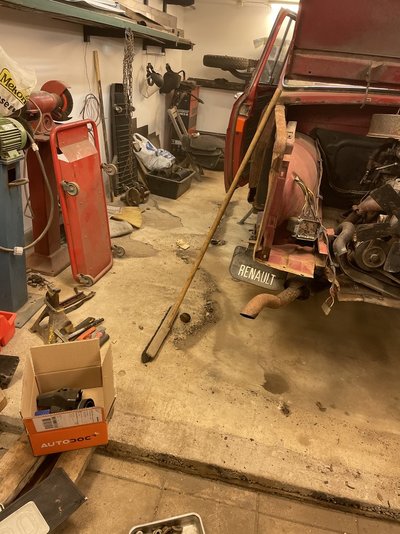

Some breakclean in the carb (as fuel) test Click wjuwju BRAPaPaAP. Yes!

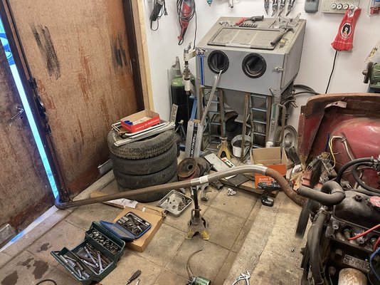

Disconnect power, put on exhaust, extending it with flex pipe and some 2" piping to be able to get exhaust out of the garage when starting up on petrol.
Put a tiny glass jar with petrol in the right hand side for fuel pump line, hooked up batteries, a snaps in the carb and turn the key. To early ignition so engine will not start, back of some timing, snaps, turn key and she starts up and sound great, put timing by ear revs her a few times YES she seems ok.
First time she start with the key in many many years, and she really sounds great. No cooling system, not working gas tank I'm happy to reach the goal I had for the day.

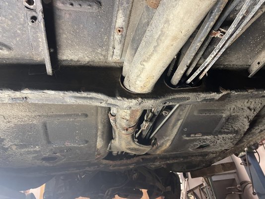

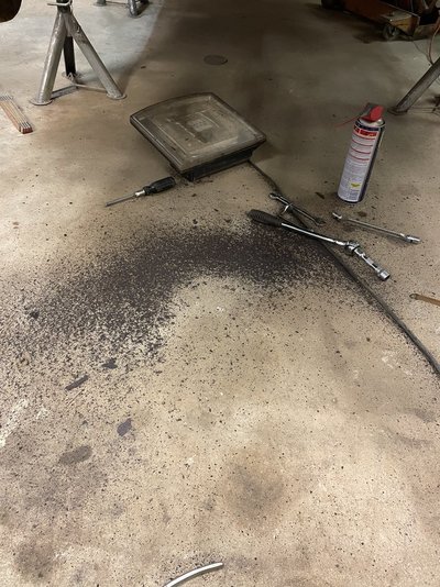

Lots of the exhaust system disintegrated to a pool of rust flakes on the garage floor.

Luckily just 24-hour left with the crazy coldness. Next week they say we have plus degrees in the area where I live.

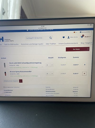

Ordered some welding primer (Inox Förch) and rust treating primer (Brunox epoxy) from Germany two rattle cans of each 106.50€ including freight. Good price compared to buy it in Sweden. This's needed to arrive before I start welding areas that will be inclosed.

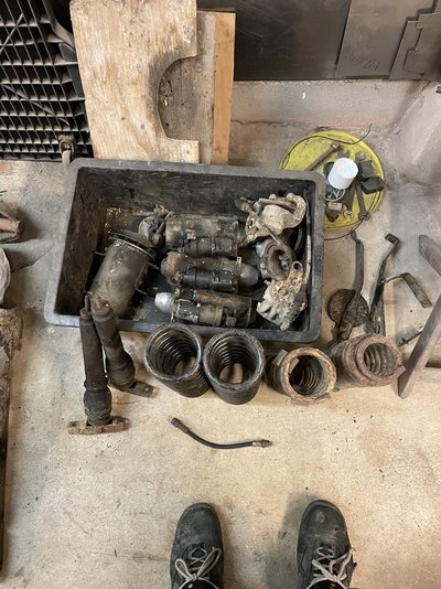

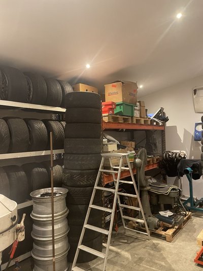

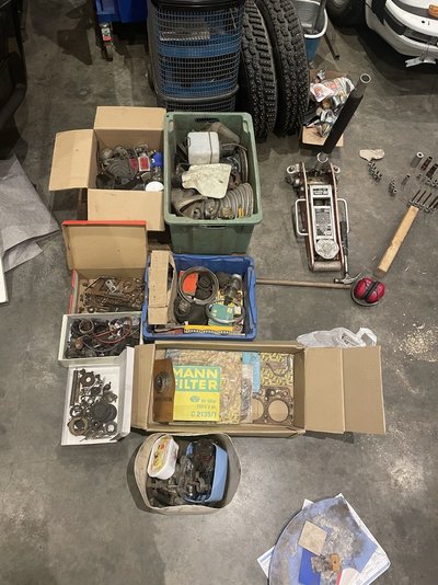

Check inventories a bit more, have a plastic box full with calipers and cool springs. Put them on the floor and in the bottom there I three more starters and an alternator.

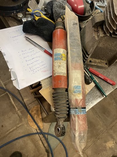

Some Bilstein B46-592 dampers I put on the shelf when I bought the car, can't find any info on that number. Think they are for R8 (single rear damper). Maybe someone can confirm.

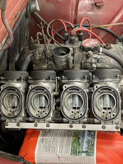

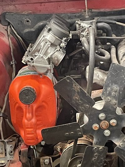

Some Keihin bike carbies and some headers maybe have lots of Porsche wheels so why not some Fuchs rims or Compomotive/Fuchs split rims.

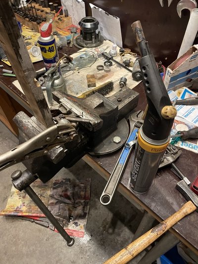

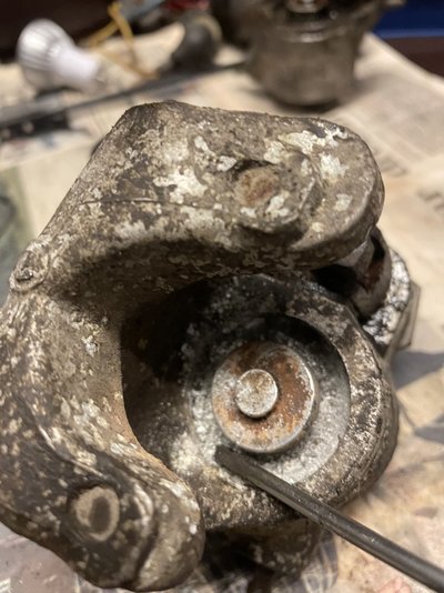

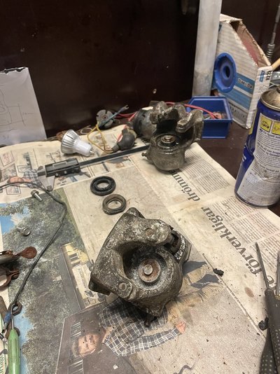

Have dismount the calipers from car!
Everything needs persuasion (WD-40, oil and heat) to come loose. All steel pieces in the aluminium calipers is coroded and very stuck (handbrake adjustment and bleeders). Hopefully I can take them apart without braking anything/to much.
I give them a week with daily treatment WD-40, heat and some tapping with a hammer. One piston is out and I looks great.
