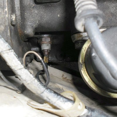

I wondered if anyone had fitted an oil gauge as I have one and cannot see how to fit a "T" piece as the gap between the engine and the chassis is too tight ? Is there some kind of adapter I need ?? :confused:

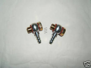

I have never fitted one on an R4. On other cars with similar clearance problems I would have a short high pressure hose made, then attach a T piece to its end so I can fit both the warning lamp and gauge senders. A banjo fitting works best for the engine end of the hose on the R4.

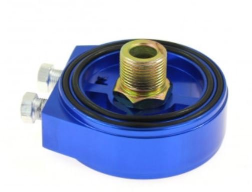

You can use the solution from later Renault 12 or Dacia 1310. There is an electrical oil pressure gauge on dashboard and its sender is placed along with the oil warning lamp sender on a hollow adaptor on the engine block. The adaptor looks like a hollow screw.

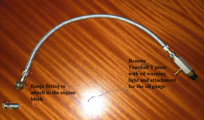

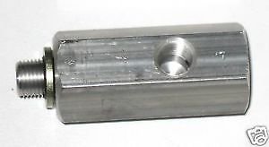

I have decided to use a "Banjo" connection on the cylinder block with a pipe to a remote "T" piece and connect the oil pressure warning light and gauge to the "T" piece ( the "T" piece is M14 for a Vauxhall ) the same size as the R4

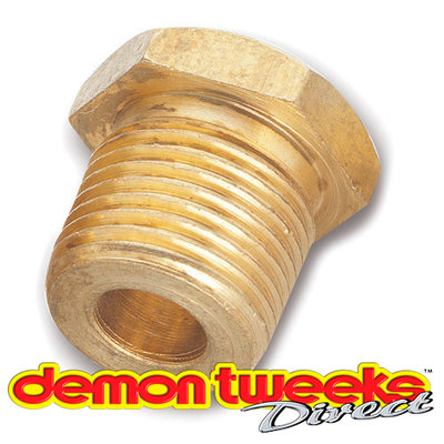

I have also fitted an adapter for the water temperature gauge which is M18 external thread size to fit the block where the original sensor was fitted, this is internally threaded to 1/8 NPT to accept most standard sensors to a Temp Gauge from Demon Tweeks on ebay
Exactly what Angel told me to do,
Just had this made up at the local hydraulic pipe shop in Limassol yesterday........It allows a "T" piece to be fitted remotely for an oil gauge and retains the oil warning light switch from the engine.
I found Vauxhall had the same size thread ( M14x1.5) to the block for the T piece but there was not enough room between the chassis to allow fitting it.
The banjo fitting to the block allows the T piece to be fitted to the bulkhead and from there you can attach the oil pressure pipe to the gauge and attach the wire for the warning light.
Cheers Angel I think it will work just fine ;)

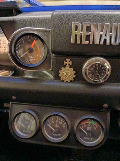

I fitted an oil pressure gauge to an air-cooled Daf a few years ago, using a t-piece to connect a pipe to the oil cooler, allowing me to mount the pressure sensor on the inside of the wing. It worked perfectly, so I reckon using a t-piece where the oil pressure warning light sensor screws into the engine block will give you two outlets, one for the light and one for the gauge.

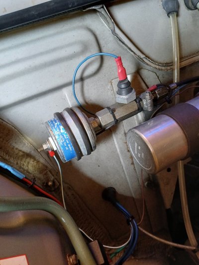

This was my solution for fitting an oil pressure gauge. A pressure sensor fitted on the bulkhead, with a small bore plastic pipe down to the engine block. There is provision for the oil pressure light sensor as well.
This was obtained from Car Builder Solutions, a British company based in Kent.20250517_122244.jpg20250517_122424.jpg
