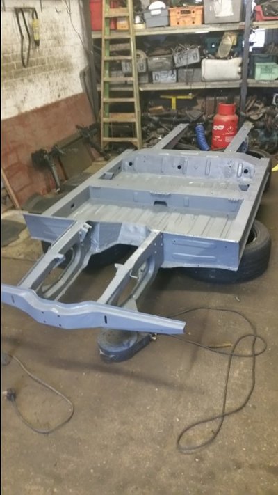

seeing as lots of people are stripping cars down 2 bare chassis thought this may be usefulPictures for the tricky bits only as pretty sure anyone going this far can manage instructions
This can be done safely and reassembly instructions will follow as and when I get that far with my project

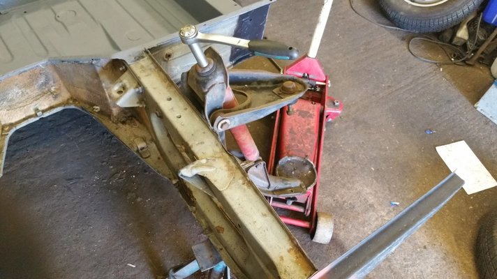

Front shocker must be left on til last to until you are ready to follow photos
position trolley jack under lower suspension arm at the extreme end jack car slightly until weight is supported undo the top shock absorber Nuts if necessary sitting on front cross member using your body weight if you have already removed the engine it should be possible to undo to the last thread with only minimal force with the trolley jack holding the tension
Remove nut carefully
it should then be possible to slide the lower mounting bolt from the shock absorber

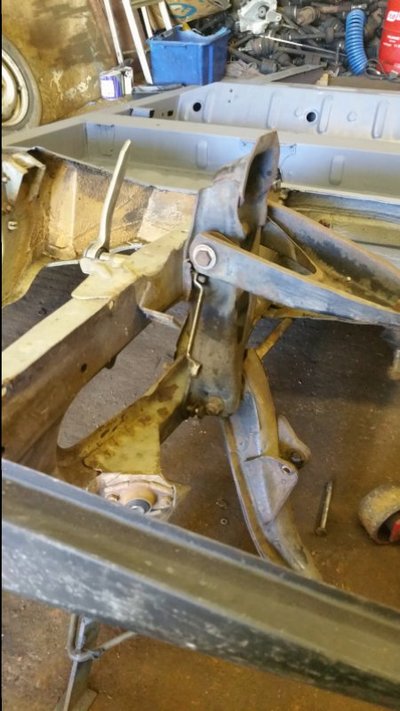

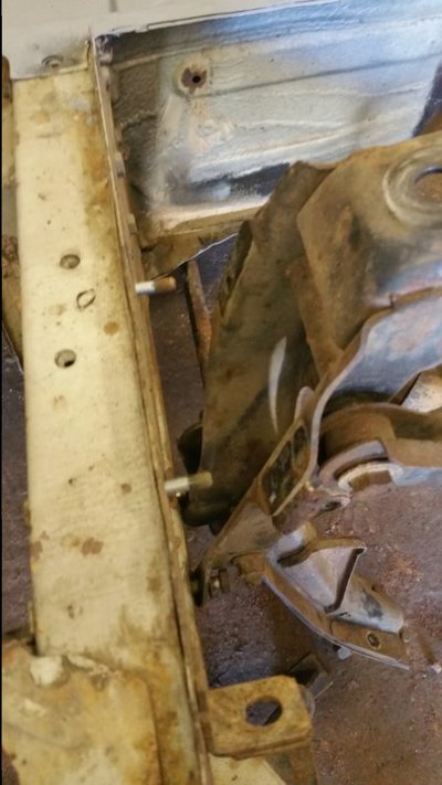

Next remove the 2 13 mill bolts holding the suspension up right to the top of chassis leg
gap will appear as the suspension tries to release again make sure the jack is under the lower arm remove bolts and then lower jack completely

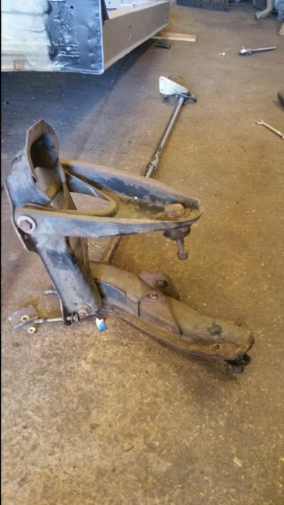

the whole suspension should now be only resting on the to lower bolts which originally held the cross member in place
remove bolts inside car on centre cross member just the three large ones and the whole suspension Will then drop out it should all remain complete with torsion bar
All done
