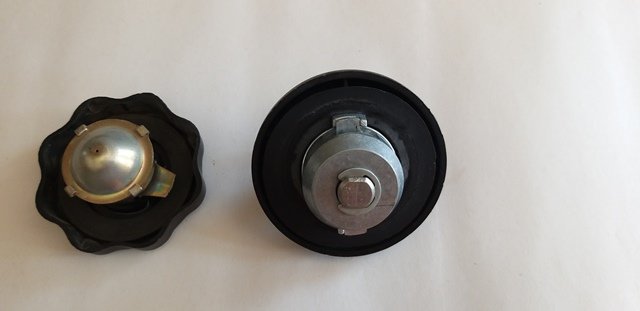

I broke down in my R4 'Noddy' today, and discovered that the fuel filter was completely empty ? Even though I fitted a new fuel pump/filter and carburettor ? So I turned the engine over like crazy for a long while and the the fuel filter finally filled up, and I was lucky enough to drive back home to my main gate...when the same thing happened again ! Maybe a fuel pump diaphragm problem ? Will investigate tomorrow.
Now my ignition key has broken in half and no spare ! Managed to get the broken bit out. Will have to get a couple of new ones cut. So not having a good day.
UPDATE: I think I have found the problem ? I replaced the original 'vented' fuel cap with a new locking cap that was 'un-vented' so it created vacuum in the fuel tank stopping the fuel coming through.
I had this happen on a friend's R4 some years ago because a parts shop gave her a cap that would fit on the filler neck (presumably from a newer Renault), without checking if it was vented or non vented. Car would stop running after a medium to long trip and would start again after some 10 minutes. When I lifted the car for some other reason, I noticed that the tank bottom (early type flat tank) had gone concave in shape!

Many thanks for all this useful info, and it's well worth remembering about the filter. I will test the fuel pump/filter when I get my new ignition keys cut next week.
Update: On checking my fuel system problem I found that the inline fuel filter and carburettor were clogged up with a fine rust sediment. So no wonder I broke down. And pumping fuel into a glass jar it is really dirty. So it's off with the petrol tank next for a clean, and check the inside with an endoscope.
