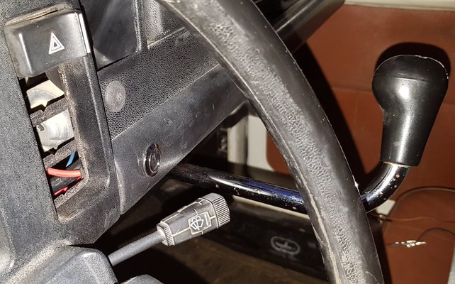

I've just bought a 'new' Spanish-built F6. It has a starter button (just to the left of the gearstick); you turn the key in the ignition switch (Neiman) as usual, and then press the button to start it.

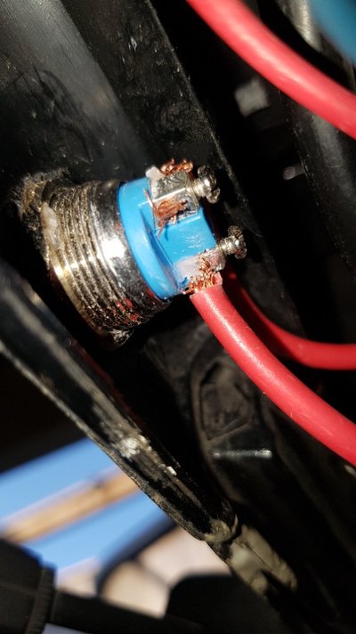

Today I had to fit a foglamp bulb in the speedo (without removing the steering wheel and speedo, a feat in itself...). I must've disturbed the wiring somewhere, because I'm back to square one. There are 12V at the starter button all the time; when I turn the key, the temp and battery lights work as normal, but when I press the starter button, there's absolutely nothing. As an experiment, I plugged in a brand new ignition switch (Neiman); the lights come on, but nothing at all happens when I turn the key to the normal starting position.

Here's the back of the starter button.

Could the starter switch itself be the culprit, the contacts within slowly burning out due to load rating?

It's the first time I've come across a starter button like this; in a way, I'd rather have the conventional ignition switch system. One strange thing, though - when I tested the starter button with a multimeter, 12V showed all the time; when I put a test bulb across it, the bulb sometimes lit up and sometimes didn't. It'd be out and then suddenly light up.

The test with the bulb and 12v proves switch contacts are on the way out, intermittent or no bulb is your starting and not when pressing button, I have only fitted this type of switch to past cars that have been nigh on impossible ( or stupid cost) to get replacement lock sets, haven't had any experience on 4s but on column usually involves hammers,chisels and swearing to get the security nuts off of barrel to column to change barrel/lock mechanism so fitting a button is a way of getting round a faulty/ intermittent starting problem on the final start position of original key operation, the fault now being repeated by push button, button press start for older car should be of a suitable rating for the current draw to starter , switch fitted just doesn’t look like a high current switch, thats the quick fix, but really you need to be looking to see if you can change the electrical switch part of ignition lock separately or the unit as a whole with new/good used to revert to original format/wiring/key start. Suitably rated starter switches should be able to source (push button type) I have found at generic classic/race car part suppliers online in past.

But if I replaced the starter button as a temporary fix, what amp rating would be right?

When I did fit in past iirc @4-5amp rated button push, this worked fine for over 3 years on Mk1 Transit without relays etc because of same type of problem with ignition barrel switch, believe it or not v early mk1 Ford Transit switches were unobtanium!
