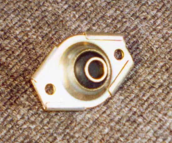

Then the engine power and the needed additional braking power will try to break the point where this part is attached (I don't know how you would call that, I'll attach the pic)

Good point - the front stay bar mounting (the bit the part in your photo attaches to) is weak - I once broke one off a chassis when I pulled over onto a verge at the side of the road and a wheel dropped into a transverse drainage ditch.
I suppose the other problems could get worse in time due to rust - the front chassis seems prone to rust where it attaches to the front of the main shell, and it's difficult to see what's going on inside that box section. Hopefully this sort of thing is only really a problem is you really use the performance by racing the car.
