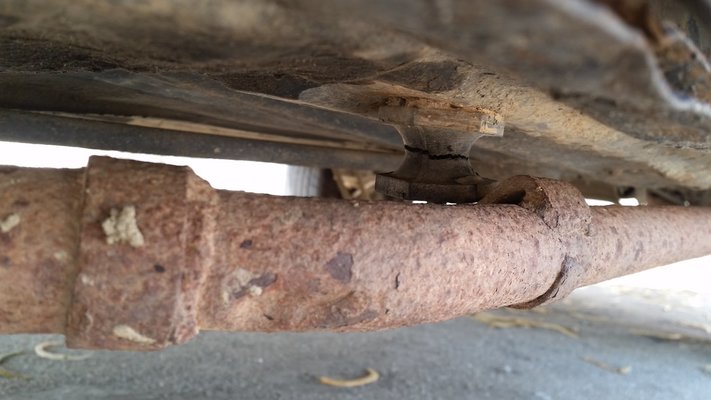

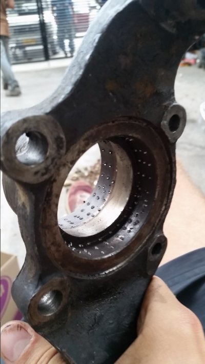

Had a chap sort a few more problems today, Clutch cable and pedal housing, steering tie rod and alignment. It was so worn where the cable mounts to the pedal it looked like the hole was twice the size.
Also sorted a knocking front hub, with a very strange (at least to me), and worrying technique. He would punch many small holes into the front hub where the bearings seat to make it more secure... there no knocking any more.

I can see it working at least short-term by tightening the fit (moving the metal around slightly to reduce the inner diameter a touch) , but wonder whether it will be a long-term solution, and whether a new bearing will make any difference to the fit. It makes some sense at the moment though :)
That method of repair is pretty old school but if combined with loctite bearing fit grade it should last as long as the bearings
Depending on availability of parts local to car this may have been only way of avoiding immobile r4 stuck in the workshop
All the front wheel bearings were replaced about a week before this engineering brilliance was perfomed on Labi.
I'd like to think I could get a new hub if I needed it, I think most people here just assume you want the job done as cheaply as possible, so they cut a lot of corners.

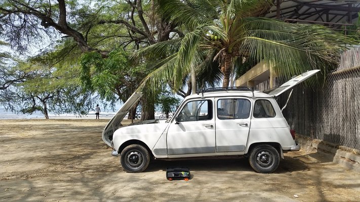

We left Santa Marta for Cartagena yesterday, all went well but oil leaks are getting worse and the front right shock has started dripping as well. GOOD TIMES!

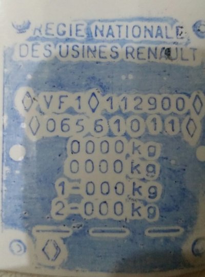

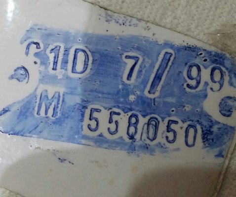

One more thing is that 1300 engine. I read that South America R4 has bigger engine. Can you identify it (engine plate). Just for science purposes :D

I'll grab the numbers for tomorrow, no biggie dude.

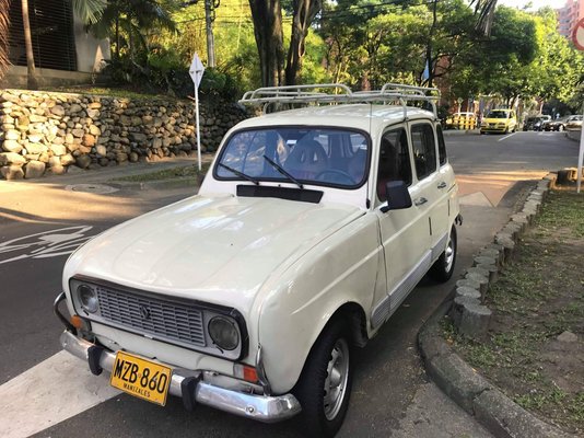

Yesterday find out that my cousin is on her vacation in Columbia and send me this picture.
Take your time... No hurry.... Tx!
Wheels looking really nice with that black center.
That is a lovely 4, similar to my friends car in Medellin, by colour at least. He took me for a ride in it today, it is fantastic to say the least... I'll upload a photo... also the chassis number.

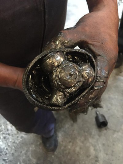

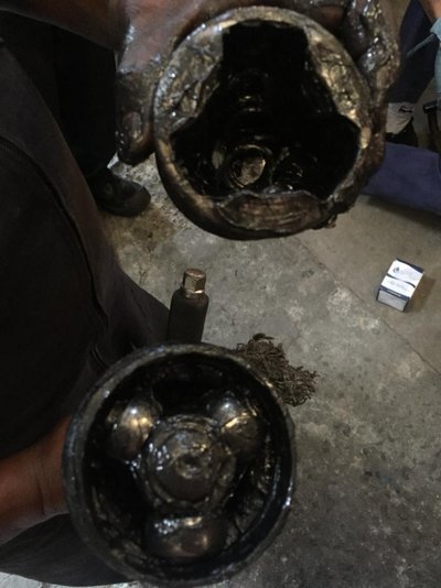

So, Labi has been in with yet another mechanic for two days. Clutch release bearing has been changed, it was completely pooped, you could rock it side to side!
- 1 gearbox side drive shaft joint replaced, as you can see in the photo it did not look good, the casing had cracked and was throwing grease everywhere.
