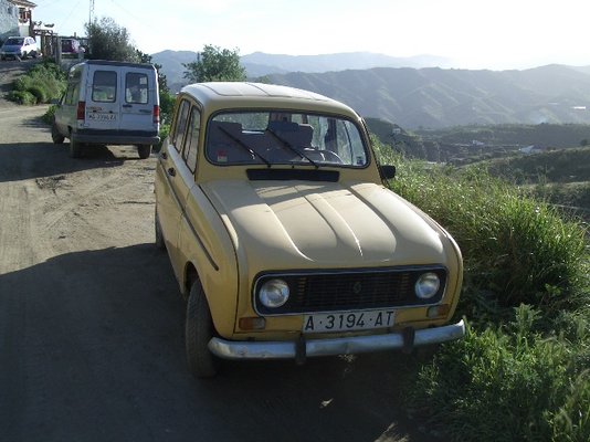

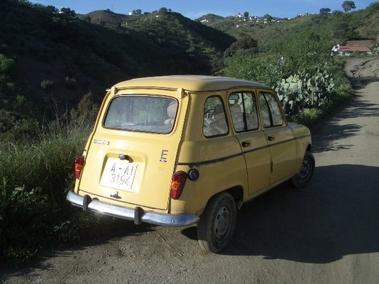

Remember the yellow R4 advertised in Spain a few weeks ago? Well I bought it! It'd done less than 70,000 kms when I got it and it's like brand new inside. There's a bit of rot around the rear wing and the door is dented but otherwise it's immaculate. The radiator blew on the way back so we had to tow it on the fixed dolly. Took the rad out of the purple peril so need to get to the scrappy for a replacement.
It seems to pink a bit up hills, do you think the timing is out due to it running on unleaded?
The Spanish build quality isn't as good as the French; the metal is a lot thinner. Also the exhaust exits on the drivers side just forward of the rear wheel! The silencer is inside the front wing! Must be a Spanish thing. It's got head rests and a vanity mirror, very posh!

Nice colour!
I thought they were all like that. You get a nice surprise when you lean on the inner wing :-)
If my memory serves me well, I'd say it's a R4 TL or equivalent later model. The TL had a 845cc engine with the silencer sitting above the left tire. My parents had 2 pale yellow TL's between '77 and '83. Yours has a much nicer, richer yellow. Nice one!!

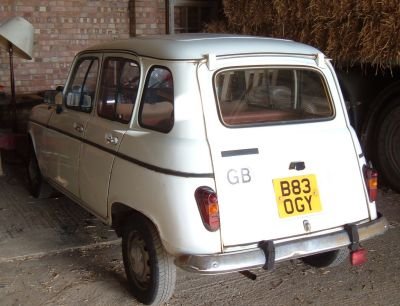

I picked this one up from Liam at the weekend. They are funny old things. Looks like the Spanish didn't quite have all the tooling to make GTLs so they carried on with the chrome door handles, dash handbrake (operating on the rear wheels), under wing silencer, raised boot hinges, chrome hubcaps, and a metal parcel shelf.
Build quality doesn't seem up to much. I don't think the seam sealing was applied all that carefully and this one has gone around the seams, but the chassis is just about immaculate.

Metal parcel shelf? I didn't know they were ever made of metal. I only remember the plastic ones. I don't think "our" first R4 had a parcel shelf, but then again I was a bit young when we had that one. My most vivid memories of that car are my mom trying to get the thing started in winter without the benefit of a charged battery and me loosing my lunch at age 5 or 6.
They all had metal parcel shelves up until about 1972, then the UK and French ones changed over to plastic ones. Seems the Spanish forgot to make the change.
Nice one Clementine! See what I mean about the build quality? Thinner metal? Also, be sure to oil those boot hinges. The bolt in one of mine was snapped when I got it (metal bolt, aluminium hinge, osmoses etc!!) and I had to drill the old one out of both sides of the hinge.
