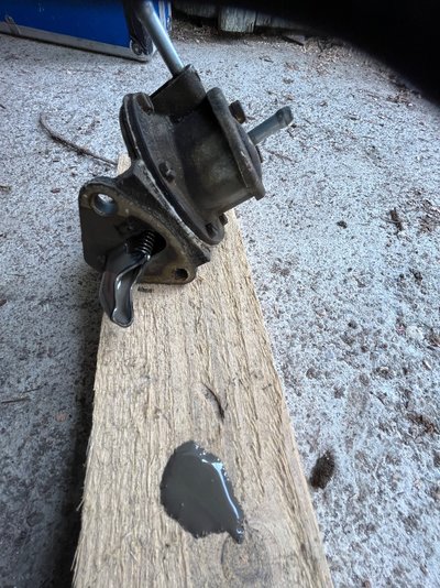

The car has been sitting for three years! Don’t ask- it was running ok but a wee bit of mayo in the oil cap, tried to start it and realised there was no fuel getting through so did the usual checks and ended up taking the fuel pump off.
What ran out from the engine was not what I was expecting…..
So I’m guessing water is getting into the engine and not sure what my next move should be ‍♂️

First thing must be to drain the muck out of the engine, so undo the sump plug & allow the contents to pour out. Once you've done that, you need to use some flushing oil to clear out the oil ways as much as possible, but this means having the engine running, so you need to put the fuel pump back on the engine, add the flushing oil to the correct level in the sump, top up the coolant and then start the engine. Allow it to tick-over, NO FASTER, and run up to operating temperature. If there's no temperature gauge judge this by the radiator hoses becoming too hot to grab; usually about 15 minutes should do it. Drain the sump again & take a look at it. See if the coolant's dropped as well. Based on the level of the coolant and the state of what drops from the sump you'll be able to judge if the head gasket's gone west. looking at your pictures may well have done so.....
