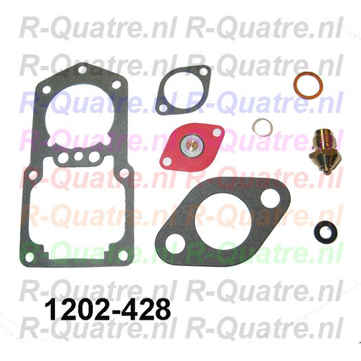

With the standard Zenith 28IF carb, you can restore some performance by drilling the main jet to 1mm, and doing a carburettor rebuild as the butterfly spindle seal can shrink and cause the engine to run lean over time. The set with the seal can be found below:
