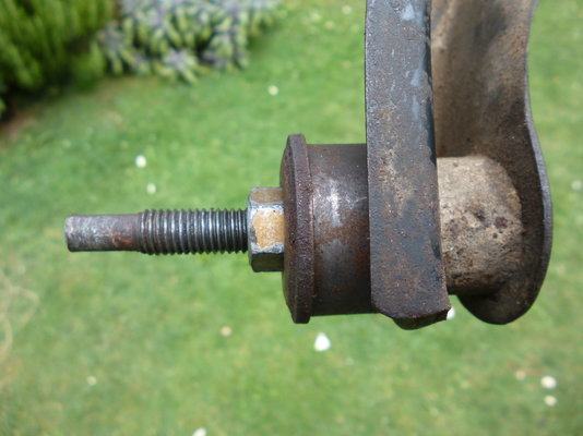

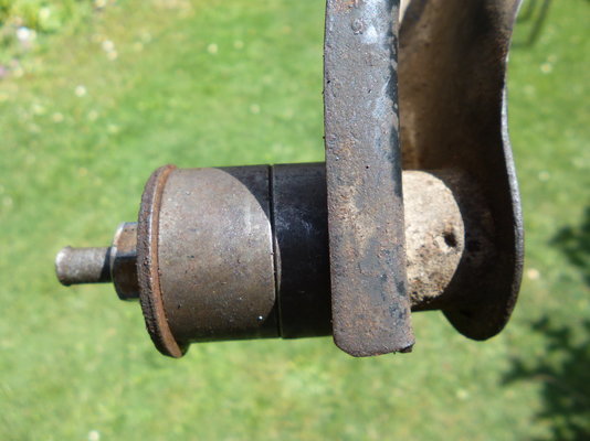

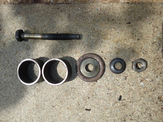

You used to be able to get Quinton Hazell upper wishbones pretty easily - QSA210S and QSA211S. But if the problem is just the bushes, you can replace them fairly easily yourself, with just a long bolt and some tubes/sockets. Just make sure you remove/replace one at a time, so the space between the two bushes remains the same. It's fiddly, requires patience, but rewarding!
