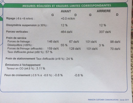

Well, I failed my MOT.
I expected the issue to be with the emissions but it was the brakes this time.
If you have a look at the results below, AVANT means front. A little way down you can see "force de freinage" which is brake force, and the 146 is the left hand front brake and 67 is the right hand front brake. So quite a difference.
The inspector told me that the right hand brake does not maintain the pressure. By this I would assume that there is something wrong with the brake cylinder or perhaps there's air in the brake line. Any thoughts please??
2 years ago my emissions test was 4,4% and this time it was only 3,11%. I've haven't touched or adjusted the carb in this time. Two months ago I stopped adding the lead additive for unleaded fuel. Do you think that this could have made a difference.??
It seems that one piston of the right front wheel cylinder is seized. With such unequal braking performance up front, I would expect the car to pull when braking, have you noticed it? Brake performance on the "good" wheel seems low, too. I remember that my '75 R1123 with 200mm drum brakes would put out 180-200 daN of braking force, back in the days when the actual force was printed on the test result sheet. So it may also be air in the lines.

Just the advice I was looking for, thanks Angel!!:)
The car does pull to the left when I brake ; the harder I brake the stronger it pulls. So I will start off with a brake bleed (you helped me with the last one) and if the problem persists I will replace the brake cylinders.
