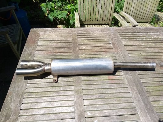

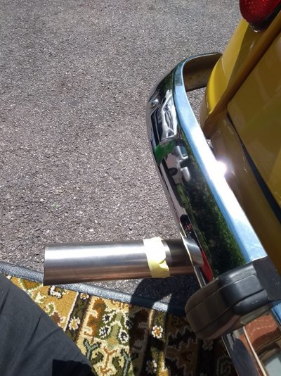

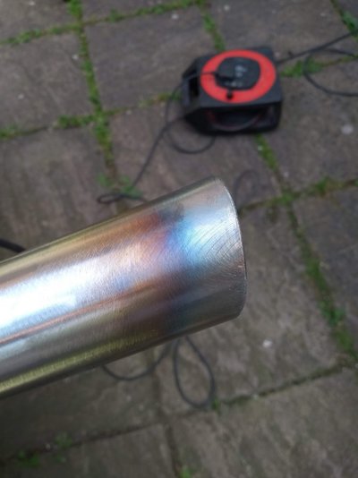

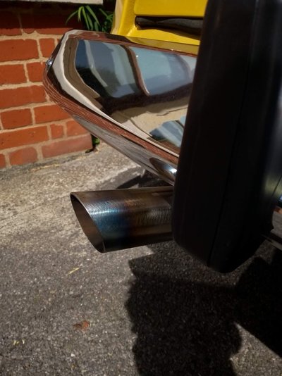

With the 4L International fast approaching we took the back box section off from stainless system and chopped off the twin pipes, then mocking up a single up-tilted and slightly left facing tail, using tape to mark the end point, which was then welded onto the single branch where the twin-pipes split from.
For a more classic look we slash cut the end at an angle and then to spice it up ( my idea of course ) we polished the tip and made merry with the blowtorch until the metal turned a blue/purple colour for a 'titanium system look'.
The new tip has improved quietness drastically and still produces a pleasant sound, with pops and crackles like the twin setup :laughing:.

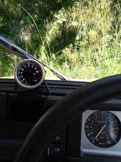

Also we fitted a rev counter, into a pod we already had, which has a nice light up display even going up to 10,000rpm ( though it may as well stop at 5500 ).
Unfortunately through erm ... rigorous ... erm ... testing ;) ,it reads around 300-500rpm too low at all speeds so it is rather pointless, thus we will contact the supplier for another item before Thenay.

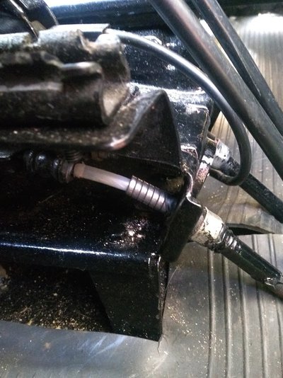

The handbrake had started snagging slightly not returning fully in one release and then a after a while it seemed to jump miles out of adjustment needing to be pulled up by double the length. We checked the rear brakes for bite, which were perfect, and then adjusted the handbrake itself, it felt much better but then found it snagging to an even worse degree, but after moving the passenger seat forward we could see the problem was that the end fitting had broken and pulled through the bracket. So a new pair of cables are going to be fitted.

our old cars always need fettling even after a full rebuild like yours

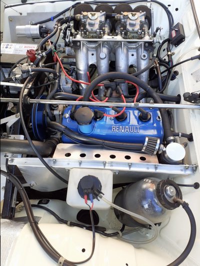

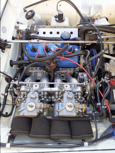

However on another note during a break from the terrible weather we've been having in the UK lately we took Dads Cream Gordini/Alpine powered R4 out and I had a little go to experience what a proper engine feels like ;). It was definetely lightyears faster that my car and especially intoxicating at higher revs. It was a strange experience glancing at the rev counter and seeing it pull past 4500 in higher gears and having a 5th gear was a nice extra :laughing:.
I now definitely know that I want a R4 with a big engine but that'll have to wait a few years ...
