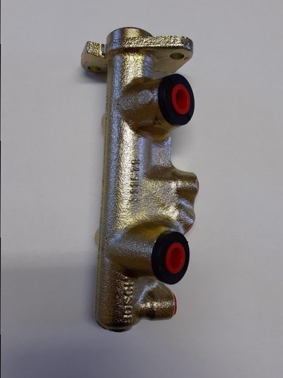

We replaced the leaking master cylinder with a refurbished Cadmium plated item. The new one also has been fitted with a stainless steel sleeve to prevent future corrosion, this is all more expensive but you end up with a much better product aesthetically and has more longevity. We bled the system with more silicone brake fluid which is also better all around and doesn't damage the paintwork so no damage was done by the old leaky master cylinder, again it's expensive but a very good product. As part of simple maintenance I cleaned coolant bottle out of sludge which tends to deposite from un-rebuilt engine.

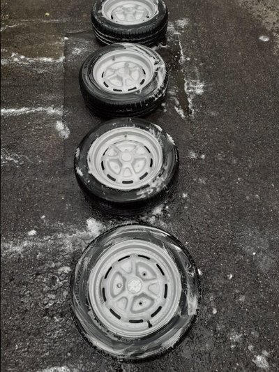

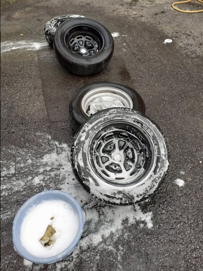

Also as part of winter protection we are temporarily swapping the 5.5" Fergats that were fitted in May for the set of standard GTL wheels that were fitted previously. Dad also found a good condition NOS wheel to add to replace the one with the filled centre hole. So I'll have to stick with skinny wheels for the time being but better that than exposing Fergats to all the salt, rain, ice and grit that gets thrown up around this time of year.

The wheel swap is now done and the the rear drivers side wheelbearing has been replaced as it had become increasing noisy over the past in, out and under all the wheel arches and inner wings ... you go down one back road and it looks like you've been on the Safari Rally :vsad:.
We also had the idea to put some stainless steel wheel trim rings used on Dad's Renault 12 that he used to drive daily that are still in good condition even after being through all weathers for several years. They make the standard GTL wheels look a bit deeper and a bit less like a toy car's. We would also like to paint the two tone sections on the Fergats black whilst they are off the car as I prefer the look and think the contrast against the yellow would look great.
With the standard wheels back on the car feels more roly and springy opposed to the go-kart feel with the wider tyres I'm used to, but the lighter steering is nice when parking.

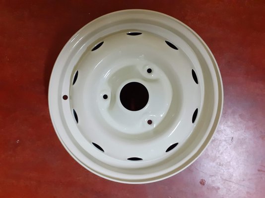

The original second color is anthracite.
If you go for originality.
From the 3 factory colours I have seen, anthracite, bronze or black depending on age and model etcetera that they were fitted to, I prefer the black.
Anyway I'm not a stickler for originality at all ... obviously :laughing:, just think the contrast with the black would look the best.

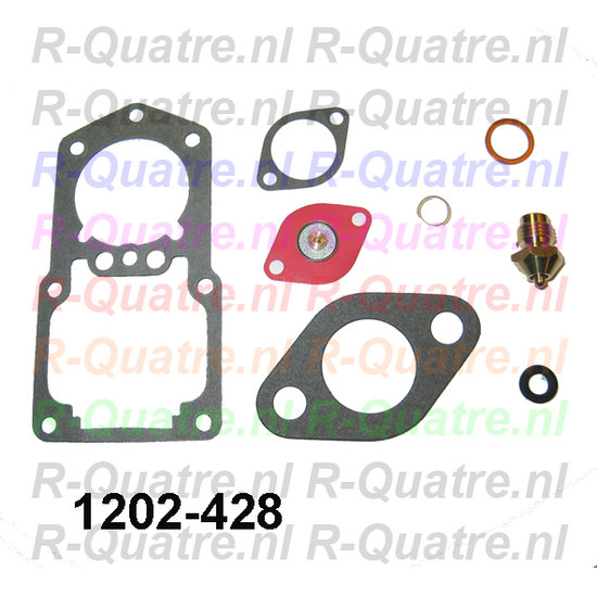

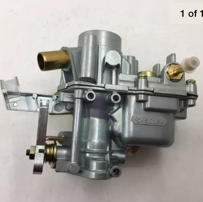

My Zenith 28if carburettor had been suffering from the typical lacklustre performance as many do, even though we have modified the main jet to compensate for this a little. The typical problem was the carburettor sucking in air past the age shrunken butterfly spindle seal and I could never find a repair kit that included said seal. This weakened the lower to mid-range performance, as we found when we took the engine through the rev range with a CO analyser attached and noticed a drastic drop in the CO reading from around 1500-3500rpm as air was being drawn in past the seal, in turn decreasing the suction through the main jet and worsening the problem further.
However, after some extensive internet trawling, I found some seals that are sold individually, though they are expensive considering they're only a bit of rubber 10mm across. But replacing the seal along with readjusting the air:fuel ratio to suit has given it back most of its cross-range flexibility, more power and allows it to rev higher and faster :p!

Ah interesting that is the supplier I used, they must now be reproducing these kits with the seal included, which is good.
When I first overhauled my 28if in 2015 that specific seal was already included even in the years before. I know that Jan-Willem, the owner of R-Quatre aka renault4onderdelen.nl, really takes care about the correct parts either aftermarket or he will search for NOS-parts.
He is a former Renault garagist and always when I pay him a visit for collecting ordered parts, there's time for coffee, talking about technique and the old days and looking at his photo-albums from his racing years driving the mighty R5 Turbo 2 and Turbo Max.

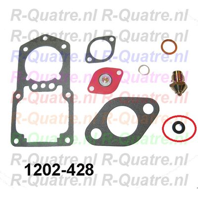

You are talking about this small ring circled in next picture
which is this rubber ring on next link?
Also searching for it as i have troubles with my second carb on the car!
Hope this seal-ring will help reducing (or solve) problems that i am having.
Yes, that is the item I was talking about, hopefully it will help the problems on your car as it did with mine.
