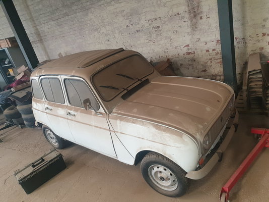

OK, the other thing I failed to achieve this evening was bleeding the brakes. I have a Bendix system. Its all been off the car. Most of it is new.
The master cylinder is new, it is the one with 3xM10 holes and 1xM12 x 1mm hole.
I plugged the M12 hole and ran a single line back to the compensator at the rear, where the lines split off to the rear wheels. All new lines and cylinders.
The front brakes bled easily after I failed to get and fluid out of the rears. Tried the rear for the second time.
I could get nothing from the rears again . Like they were not connected to the master!
I thought I might have air in the master, so I pulled a vacuum on the master bleed nipple. Nothing.
I removed the master bleed nipple. No fluid coming running out. I pocked a bit of MIG wire up it for fun. Nothing.
I now have some front brakes and no rear brakes. Any ideas?
Is my compensator cutting off the fluid with the wheels off the ground?
