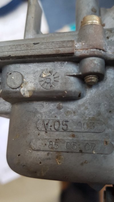

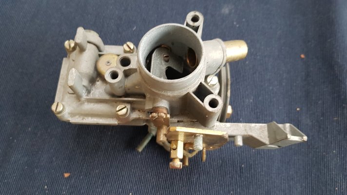

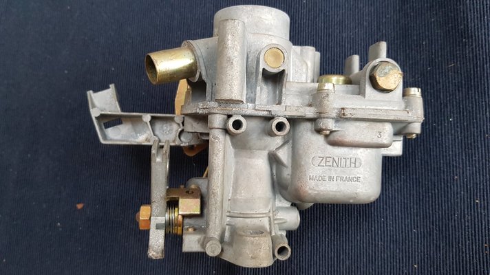

Andy McGhee Enthusiast Messages 1,879 Location Cheltenham Saturday at 5:33 PM #1 I found this in the garage while looking for other parts. It's a NOS Zenith 28IF V05 903 from 1985; I've never seen one like it - can anyone identify it?
JdeW Enthusiast Messages 1,143 Location Laarbeek The Netherlands Yesterday at 8:52 AM #2 It's a Zenith IFG for a Renault 4 210B GPL (R4F4) with 688D7/12 engine so indeed for LPG
Andy McGhee Enthusiast Messages 1,879 Location Cheltenham Yesterday at 8:58 AM #3 Excellent - many thanks, Joop!
